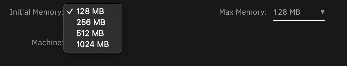

There are no options above 1024 Mb listed. image.thumb.png.d36c6e60d45aff43be0c5c6d61589faf.png
Tools -> Diagnostics -> attach zip file.
Do you really have 1TB of RAM? I'm guessing that's confusing Unraid, probably first user with so much RAM.
Yes.
You should create a bug report, my guess is that it's not converting TB to GB, and anyone with >= 1TB of RAM will have this issue.
Thank you. I will do that.
So I removed half of the installed RAM (512 GB) and am now presented with options in the VM template to utilize all installed RAM.
Thanks @johnnie.black

No problem, I expect this to be fixed next release.
1 hour ago, davcollins said:
So I removed half of the installed RAM (512 GB) and am not presented with options in the VM template to utilize all installed RAM.
While waiting for the fix, you should be able to manually edit the RAM amount in the xml instead of using the template.
