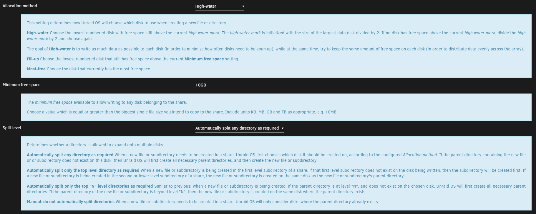

This is the User Share setting called Allocation Method. There are 3 choices, High-water (default), Most Free, and Fill Up. High-water is a compromise for distributing files without constantly switching between disks.

By definition a share is any top-level folder on any disk in the array.  Let's take the example of a "Media" share.  If you create a "Media" share in unRAID or if you create a folder on a disk called "Media" that is a top-level folder it is a user share in unRAID.  If you define the share to span multiple disks, there may eventually be a folder named "Media" on all of those disks.  When this folder gets created on a particular disk is determined by the allocation and split-level settings for a share.  The "Media" folder may exist only on one disk when it is first created but, as the amount of data stored gets larger and larger, it will spill over onto other disks included in the share following the allocation and split-level settings and a "Media" folder will be created on all disks as they are needed.
Sub folders of "Media" for example, Photos, Movies, Music, Videos, etc. are not shares.  You cannot create separate disk assignments for these sub folders.  They will utilize the same disks as their parent or top-level folder share, but, they will obey the allocation and split-level settings of the share in determining on which disks that are included in the share the contents of these folders will reside.  If you want to create separate disk assignments for Photos, Movies, Music, Videos, etc., they must be shares (top-level folders) and not merely sub-folders of a user share.
Here is the help text for these settings in the Shares tab which may help you better understand how shares work and how these settings influence the location of files (top-level and sub-folders) that belong to a particular share:
33 minutes ago, Hexenhammer said:
For the workstation PC its all visible as Single Drive letter disk with pre-generated folders.
unRAID itself has no concept of drive letters, but, of course you can map a share to a drive letter in Windows if you wish.  Any sub-folders that are created under that share will be visible under that drive letter in Windows.  You can create sub-folders as needed in any share.  Again, nothing is a "share" unless it is a top-level folder.
In summary, yes you can create a single share that spans all available disks if you wish, but, you will not have independent control over which disks any sub-folders of that share may span.  The only control you have is with allocation and split-level settings.  If you want an individual folder to be limited to a certain set of disks and you want a different folder to be limited to a different set of disks, these folders need to be top-level folder or user shares in unRAID.

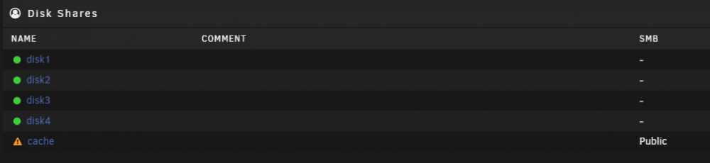

Parity disk(s) are never exposed to clients.  There are no shares (or even a filesystem) on a parity disk and they cannot be exported as disk shares.  They are just big buckets of bits.
I have one parity disk, four data disks and an SSD cache drive
I can choose to export the data disks and cache disk as disk shares if I wish to (only cache is publicly exported in my case).  There are also some more secure ways to export array disks. Parity is never visible.
The appdata, system and iso shares should generally be kept on the cache drive.  However, you can install VMs/virtual disks anywhere you want.  I also have an unassigned  1TB SSD (not part of the array) disk that I use for VMs and the landing place for downloads before I decide what to move to the array. In addition, I have a 256GB NVMe SSD that I am figuring out how to use best as either a "cache" drive or an unassigned device.
Docker containers should generally be in the appdata share on the SSD cache drive or pool, but, some have even opted to move those to an unassigned device.
