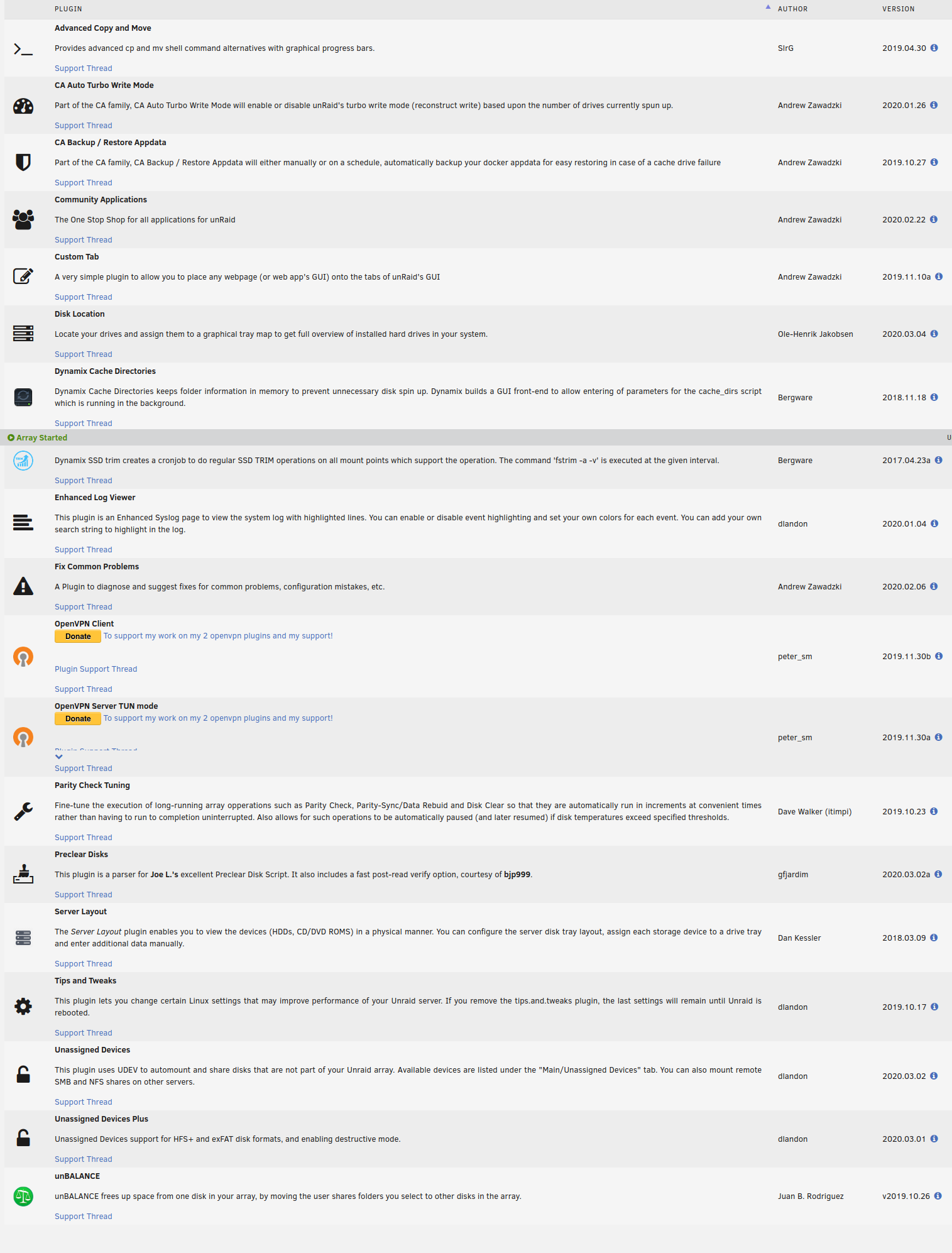

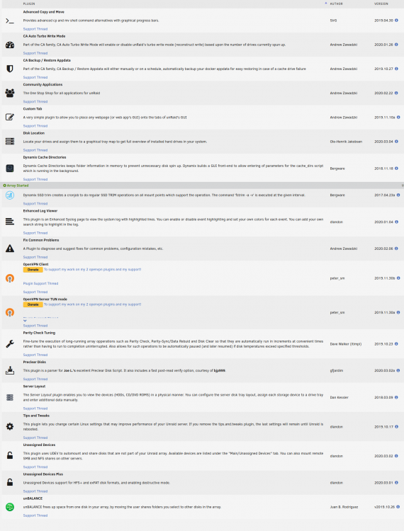

Hi everyone,
I'm running unRAID Version: 6.8.2
I am semi-new to this system and I did not realize it was not good to write corrections to parity. I've been trying to figure out the problem and I cannot. Sonarr and Radarr are not communicating with any of my indexers through Jackett, so I tried Cardigann, still no luck. Deluge won't open anymore, when I try to open the webGUI, it says "page not found". I tried different browsers with no luck. I tried to switch to qBittorrent with no luck there either. I'm hoping someone here can help me figure out what's going on with my system or point me in the right direction.
Thank you in advance.
alienblood-diagnostics-20200304-2319.zip
