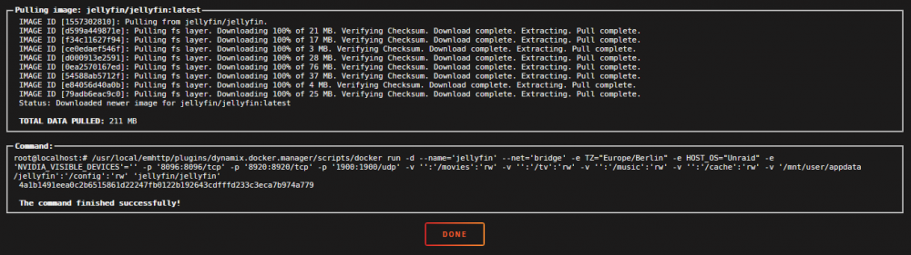

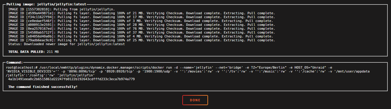

@Yang-LU I quickly tried to to pull the jellyfin/jellyfin docker from your first post and I had no issues installing it.
Your Timezone is set to Asia/Shanghai so I guess your server is in China. The "certificate has expired or is not yet valid" might indicate you're not able to reach the source of the docker you try to pull. Not sure how many chinese users Unraid has and where the limitations are in China but for me it looks like you can't reach the site for the docker where it is hosted.
