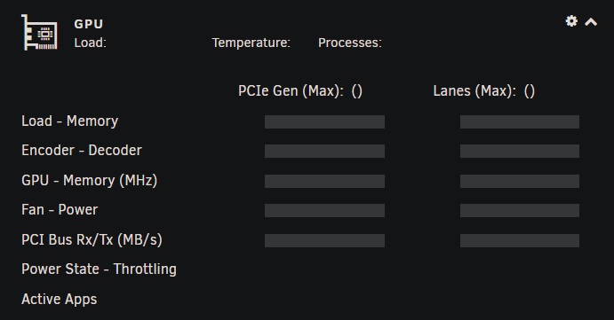

    Good day, plugin also stopped working for me.   root@Unraid:/usr/local/emhttp/plugins/gpustat# cd /usr/local/emhttp/plugins/gpustat/ && php ./gpustatus.php Fatal error: Uncaught TypeE
  • I did some more work to get it to look like the CPU sidebar that comes with unraid
  • I have created a PR for b3rs3rk's plugin to add MultiGPU support for 6.12 as Dashboard panels are different in 6.12. The PR works on pre realeases but does not provide Multi support. There are some ot
I'm having the N/A issue. Running 'cd /usr/local/emhttp/plugins/gpustat/ && php ./gpustatus.php' gave a fatal error. Running 6.11.5, latest Nvidia and GPU Stat plugin. Plugin was working fine since it came out. While running the commands i've attached, there was an Emby transcoding going on.
gpustat.txt gpustatus.txt nvidia-smi.xml
Fatal error: Uncaught TypeError: Argument 1 passed to gpustat\lib\Main::getParentCommand() must be of the type int, string given, called in /usr/local/emhttp/plugins/gpustat/lib/Nvidia.php on line 90 and defined in /usr/local/emhttp/plugins/gpustat/lib/Main.php:161
Stack trace:
#0 /usr/local/emhttp/plugins/gpustat/lib/Nvidia.php(90): gpustat\lib\Main->getParentCommand('ffmpeg\x00-hide_ba...')
#1 /usr/local/emhttp/plugins/gpustat/lib/Nvidia.php(355): gpustat\lib\Nvidia->detectApplication(Object(SimpleXMLElement))
#2 /usr/local/emhttp/plugins/gpustat/lib/Nvidia.php(250): gpustat\lib\Nvidia->parseStatistics()
#3 /usr/local/emhttp/plugins/gpustat/gpustatus.php(63): gpustat\lib\Nvidia->getStatistics()
#4 {main}
  thrown in /usr/local/emhttp/plugins/gpustat/lib/Main.php on line 161

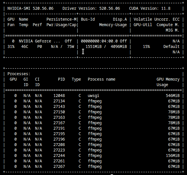

Another one with the blank stats issue, if I stop my frigate docker container, the stats page works correctly, starting the docker container again makes it go blank. Reverting to the feb release as a work around is working.
Edited by Endolf
I see the issue, dumb mistake on my part.  Will push a new release shortly that should fix the problem.
EDIT:  Released, sorry!
Edited by b3rs3rk

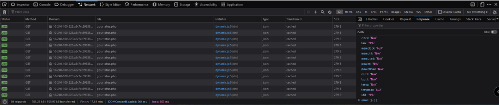

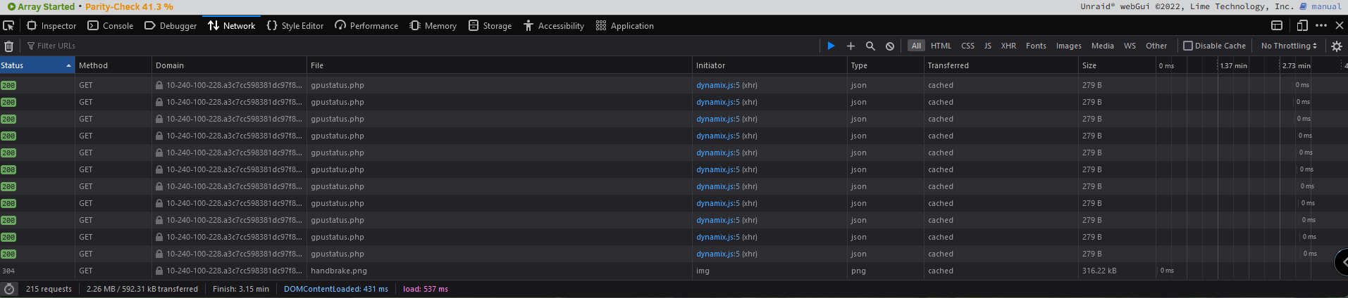

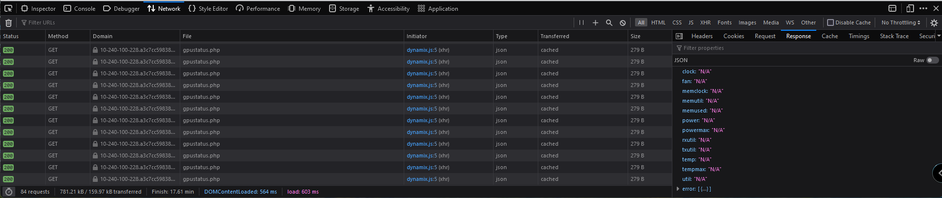

11 hours ago, b3rs3rk said:
The only thing I'm missing is number 2 from that same list in the first post.  I need to see what is getting spit out when the data collection actually runs.
Sure thing:
{"clock":"442","fan":"N\/A","memclock":"715","memutil":"0%","memused":"0","power":"27W","powermax":"250","rxutil":"2","txutil":"0","temp":"32 \u00b0C","tempmax":"85 \u00b0C","util":"1%","vendor":"NVIDIA","name":"Tesla P100-PCIE-16GB","clockmax":"1328","memclockmax":"715","memtotal":"16384","encutil":"0%","decutil":"0%","pciemax":16000,"perfstate":"P0","throttled":"No","thrtlrsn":"","pciegen":3,"pciegenmax":3,"pciewidth":16,"pciewidthmax":16,"sessions":0,"uuid":"GPU-5ab1abde-31a8-eaa3-d02a-d75ad238d36d","plexusing":false,"plexmem":0,"plexcount":0,"jellyfinusing":false,"jellyfinmem":0,"jellyfincount":0,"handbrakeusing":false,"handbrakemem":0,"handbrakecount":0,"embyusing":false,"embymem":0,"embycount":0,"tdarrusing":false,"tdarrmem":0,"tdarrcount":0,"unmanicusing":false,"unmanicmem":0,"unmaniccount":0,"dizquetvusing":false,"dizquetvmem":0,"dizquetvcount":0,"ersatztvusing":false,"ersatztvmem":0,"ersatztvcount":0,"fileflowsusing":false,"fileflowsmem":0,"fileflowscount":0,"frigateusing":false,"frigatemem":0,"frigatecount":0,"deepstackusing":false,"deepstackmem":0,"deepstackcount":0,"nsfminerusing":false,"nsfminermem":0,"nsfminercount":0,"shinobiprousing":false,"shinobipromem":0,"shinobiprocount":0,"foldinghomeusing":false,"foldinghomemem":0,"foldinghomecount":0,"appssupp":["plex","jellyfin","handbrake","emby","tdarr","unmanic","dizquetv","ersatztv","fileflows","frigate","deepstack","nsfminer","shinobipro","foldinghome"]}
11 hours ago, Joker169 said:
Sure thing:
If you look at the Dashboard page and open the Developer console of your browser are you getting any errors?  Anything coming up in the UnRAID system log when accessing that page?  Your diagnostics upload from before didn't show anything but I just want to be sure.  Near as I can tell with all the information you gave me there really shouldn't be an issue.
The only errors in console tab were these:
[UPC_ENV]  local Dashboard:539:27
Result: CA Background Scan Dashboard:753:11
This site appears to use a scroll-linked positioning effect. This may not work well with asynchronous panning; see https://firefox-source-docs.mozilla.org/performance/scroll-linked_effects.html for further details and to join the discussion on related tools and features! Dashboard
Scroll anchoring was disabled in a scroll container because of too many consecutive adjustments (10) with too little total distance (0 px average, 0 px total). jquery.apexcharts.js:6:6213
Didn't seem anywhere related to the plugin

When watching the Network tab of the Developer console and sitting on the Dashboard, do you see repeated calls to gpustatus.php?  To me it looks like your dashboard isn't even attempting the Javascript-based calls to populate the data.
Yes, several GET requests to the point of spamming requests. You asking this must mean you either have an idea of the fix or know there is a issue with Unraid.
It 'spamming' is correct and configurable as to how often the javascript runs the collector to refresh the widget if it's too often for your liking, but there's really no other way to do it.  If you click on any one of those requests and look at the actual response, does it reflect the same data as manually running the gpustatus.php script from the CLI (from the troubleshooting steps)?
Vastly different, the response returned the N/A at for all of the data:
Were-as the CLI script returned with same as before:
{"clock":"1189","fan":"N\/A","memclock":"715","memutil":"24%","memused":"3874","power":"32W","powermax":"250","rxutil":"0","txutil":"0","temp":"30 \u00b0C","tempmax":"85 \u00b0C","util":"0%","vendor":"NVIDIA","name":"Tesla P100-PCIE-16GB","clockmax":"1328","memclockmax":"715","memtotal":"16384","encutil":"0%","decutil":"0%","pciemax":16000,"perfstate":"P0","throttled":"No","thrtlrsn":"","pciegen":3,"pciegenmax":3,"pciewidth":16,"pciewidthmax":16,"sessions":3,"uuid":"GPU-5ab1abde-31a8-eaa3-d02a-d75ad238d36d","plexusing":false,"plexmem":0,"plexcount":0,"jellyfinusing":false,"jellyfinmem":0,"jellyfincount":0,"handbrakeusing":false,"handbrakemem":0,"handbrakecount":0,"embyusing":false,"embymem":0,"embycount":0,"tdarrusing":false,"tdarrmem":0,"tdarrcount":0,"unmanicusing":false,"unmanicmem":0,"unmaniccount":0,"dizquetvusing":false,"dizquetvmem":0,"dizquetvcount":0,"ersatztvusing":false,"ersatztvmem":0,"ersatztvcount":0,"fileflowsusing":false,"fileflowsmem":0,"fileflowscount":0,"frigateusing":false,"frigatemem":0,"frigatecount":0,"deepstackusing":true,"deepstackmem":3872,"deepstackcount":3,"nsfminerusing":false,"nsfminermem":0,"nsfminercount":0,"shinobiprousing":false,"shinobipromem":0,"shinobiprocount":0,"foldinghomeusing":false,"foldinghomemem":0,"foldinghomecount":0,"appssupp":["plex","jellyfin","handbrake","emby","tdarr","unmanic","dizquetv","ersatztv","fileflows","frigate","deepstack","nsfminer","shinobipro","foldinghome"]}
New updates fixed the issue of blank data. thanks but the latest one (2022.11.30a) does not detect frigate anymore.

Can you expand the error property in those responses and share?
Hmm, I was under the impression that it hasn't worked yet.  When did it start working for you?
11.29 worked fine (i think) :)
Sure.
0	Object { code: 302, message: "Vendor command returned unparseable data.", extra: "" }

Version 2022.11.30a I get N/A for everything as well, just adding that here.  I have had this for a while and thought it was just something I did, good to see its not just me.
Edit: Rolled back per the person a few posts back and it works, thanks!!
