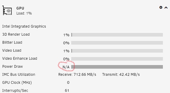

00:02.0 VGA compatible controller: Intel Corporation RocketLake-S GT1 [UHD Graphics 730] (rev 04)
powerdraw.txt
Edited by jaybigman77
more info
1 hour ago, jaybigman77 said:
how can i fix this error lastest version
You provide very little information, can you please post your Diagnostics?
What iGPU are you using, it is possible that your iGPU doesn't output the power draw.

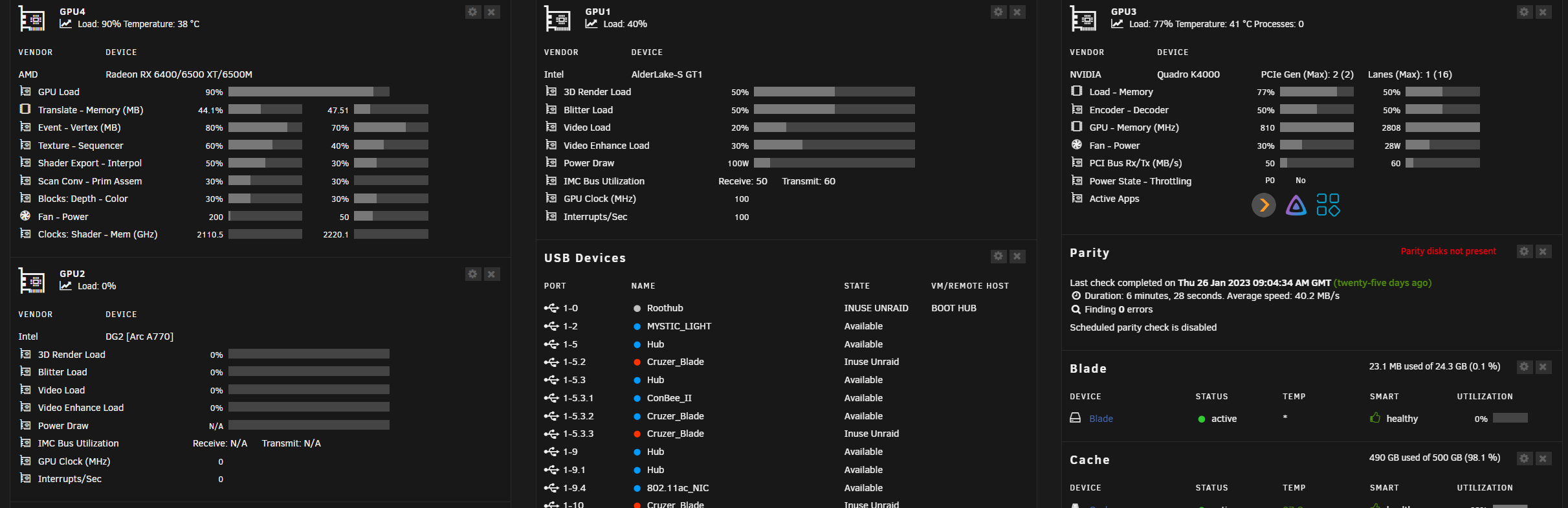

I have created a PR for b3rs3rk's plugin to add MultiGPU support for 6.12 as Dashboard panels are different in 6.12. The PR works on pre realeases but does not provide Multi support. There are some other enhancements like being able to select Intel iGPU or ARC cards. Adding the correct model on the screen. Selection for Intel to select the GPU/Package or Max of the them for Powerdraw as the driver doesn't always report GPU.
You can review the PR here: https://github.com/b3rs3rk/gpustat-unraid/pull/52
b3rs3rk's is currently reviewing the PR. Note the image is with test data, but there are other images on the PR.
