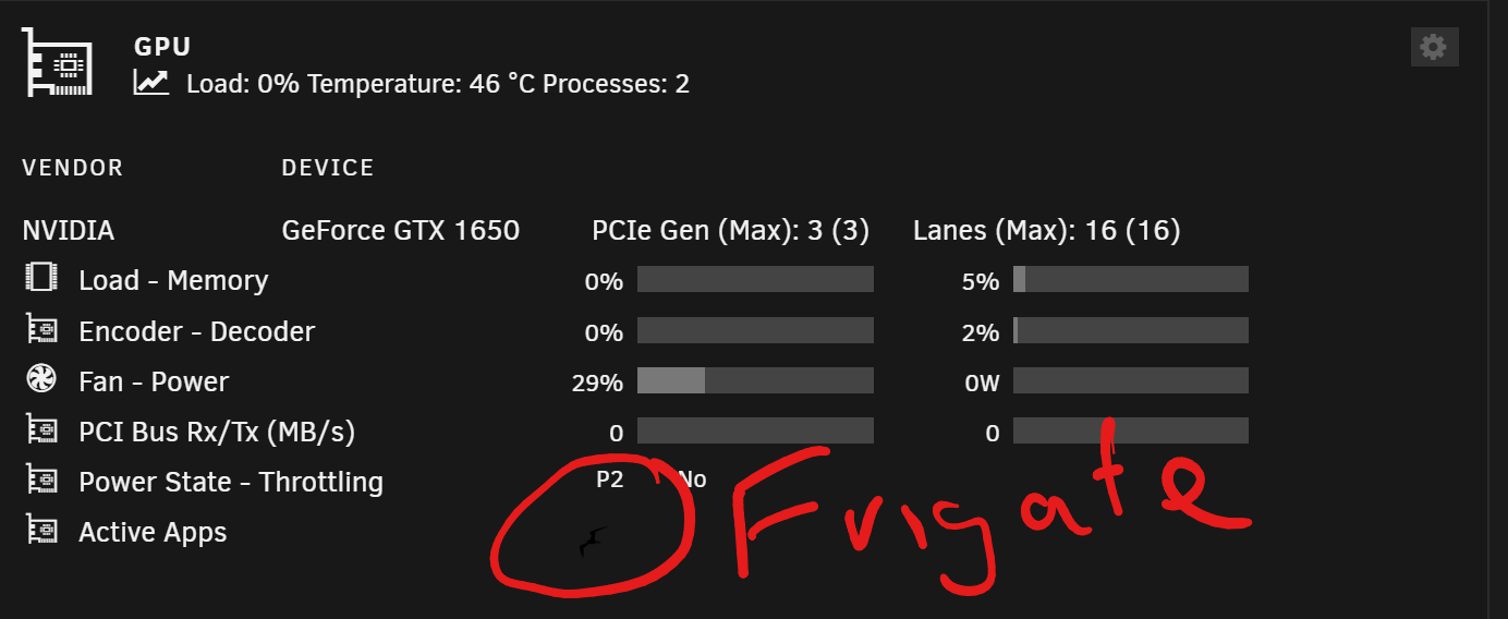

On 4/27/2023 at 9:17 PM, husqnz said:
More of a suggestion than an issue - for those of us who use the Dark theme, it would be good for there to be a light/white background for logos of apps which are also dark (Frigate is the main one which comes to mind).
Obviously not a priority but a nice to have ;)

On 5/9/2023 at 9:21 PM, husqnz said:
Depending on your screen contrast/brightness settings, you should be able to see a faint black frigate bird - in dark mode, hard to see. Fine in light mode obviously!
If you can provide a png file I can look to replace the existing one. I can only find all black.
Well, Frigate, it's not that important.

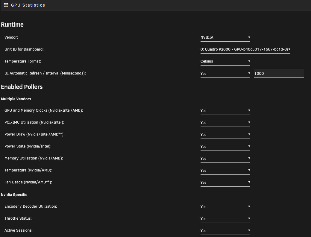

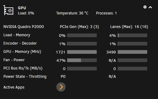

Recently Power and Throttling wont show up. I only got N/A - The GPU is a nVidia P2000. Unraid 6.11.5. Any idea why it's not displayed? I recently updated my bios and while i was at it i updated my Intel Management Engine Firmware. Everything works just fine except this.
diagnostics-20230601-2049.zip

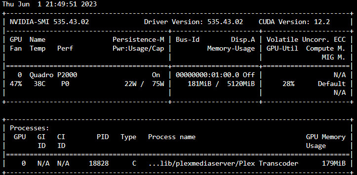

what output do you get from nvidia-smi -q -x -g 0
32 minutes ago, ezek1el3000 said:
Looks like the driver may have changed output. GPU Stat is looking for power_readings but now seem to be module + gpu.
Throttle does not seem to be reported @ich777 is 535.43.02 a newish update?
