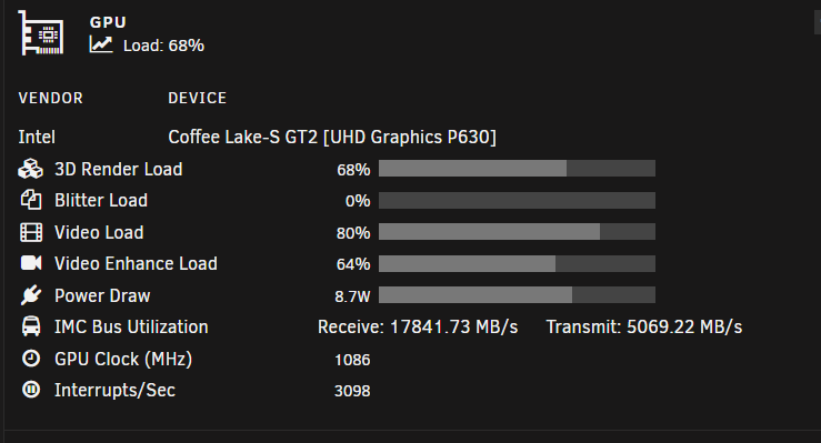

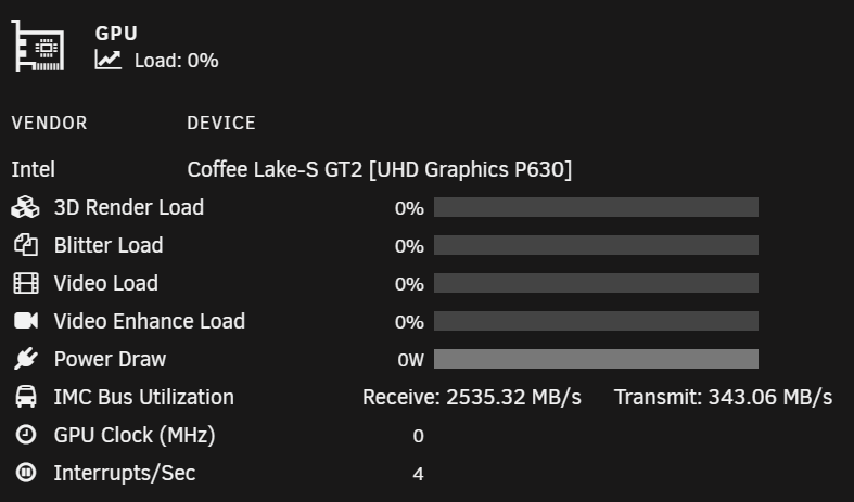

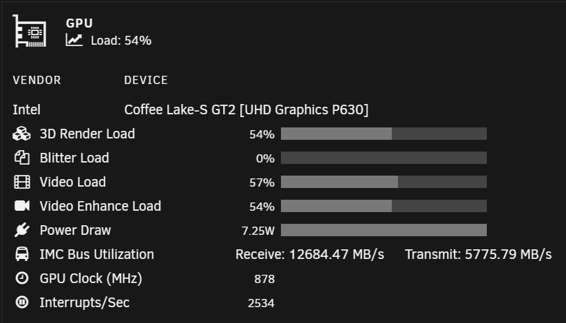

Thanks for this cool plugin.  I just updated it yesterday to the newest version.
Minor issue(s), The Power Draw graph is always at 100% no matter the amount of power being used by the Intel GPU.  The numbers in watts change next to the graph, but the graph always stays at 100%.
Also, the Blitter Load never seems to change.  Is that measurable on my system?
 SuperMicro X11SCZ-F, Xeon E-2288G, with unRAID 6.12.0.  GPU Statistics 2023.06.10.

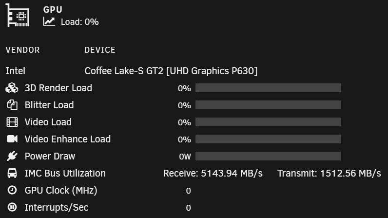

My bar is zero as below.

root@unRAID:/usr/local/emhttp/plugins/gpustat# cat /tmp/gpujson
Time = Sat, 17 Jun 2023 23:02:17 -0500
{"00:02.0":{"clock":0,"fan":"N\/A","memclock":"N\/A","memutil":"N\/A","memused":"N\/A","power":"0W","powermax":"N\/A","rxutil":"6930.42 MB\/s","txutil":"2624.87 MB\/s","temp":"N\/A","tempmax":"N\/A","util":"0%","vendor":"Intel","name":"Coffee Lake-S GT2 [UHD Graphics P630]","3drender":"0%","blitter":"0%","interrupts":4,"powerutil":"0%","video":"0%","videnh":"0%","panel":1}}
Nothing running at the time.
Edited by craigr
Time = Sun, 18 Jun 2023 01:07:32 -0500
{"00:02.0":{"clock":1086,"fan":"N\/A","memclock":"N\/A","memutil":"N\/A","memused":"N\/A","power":"8.7W","powermax":"N\/A","rxutil":"17841.73 MB\/s","txutil":"5069.22 MB\/s","temp":"N\/A","tempmax":"N\/A","util":"68%","vendor":"Intel","name":"Coffee Lake-S GT2 [UHD Graphics P630]","3drender":"68%","blitter":"0%","interrupts":3098,"powerutil":"100%","video":"80%","videnh":"64%","panel":1}}
Few transcodes running.
My power draw bar graph is suddenly working correctly.  Nothing that I know of has changed.  I have not even rebooted the server.
Spoke too soon.  I tried a transcode and no matter how much power draw (0.1 - 10 w) the bar stayed at 100%.  Now with zero draw it's at 100% again.
