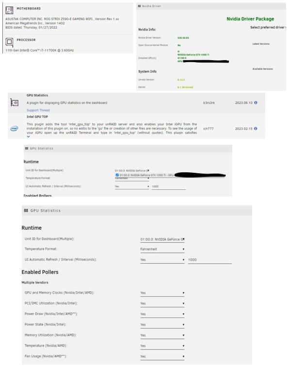

My GPU Statistics was working a few Unraid versions ago. I could switch between the iGPU and installed Nvidia. However there was an UNRAID version that said the GPU Statistics plugin was incompatible, so it uninstalled upon upgrade.  I decided this week to check to see if there was any movement on it and I was happy to see that there was.
Yesterday, i reinstalled GPU Statistics and it only shows the Nvidia card. I reinstalled Intel GPU Top and rebooted and still no change. I took some advice above and set my bios default to CPU Graphics and still no change.
The GPU Statistics works fine with the Nvidia and I can see processes, but it would be nice to figure out how to show the iGPU or at least switch back and forth again.
Diagnostics attached.
Any help or suggestions are greatly appreciated.
CPU: Intel Core i7-11700K
MB: ROG STRIX Z590-E
RAM: 64 GB DDR4
Graphics: Nvidia GeForce GTX 1050Ti
diagnostics-20230706-1434.zip

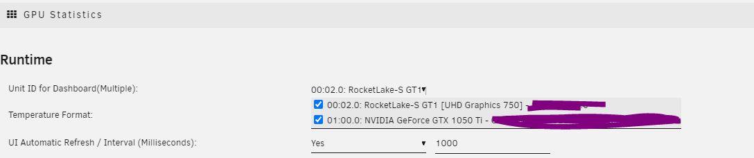

I did think checking BOTH cards in the GPU Statistics Unit ID would show both on the Dashboard, but that's not the case. at least I can toggle between the two of them.

You should have two panels initially one will be in column 1 and the other in 2 on the dashboard.
If you ru. lspci in the terminal it will list alll pci devices igpu was missing.
Yeah, that's where is was! Wow, I feel stupid. Again, thank you for all your help!!!

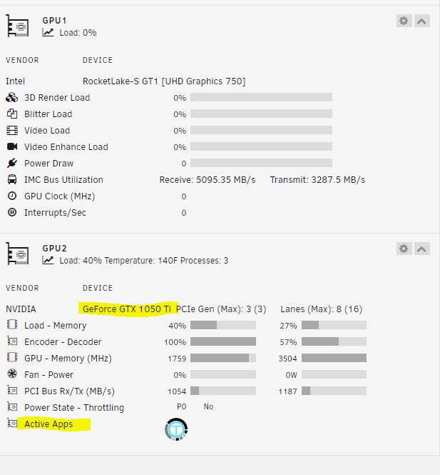

The NVIDIA has an Active Apps section (mine currently running Tdarr).
I don't see it for the iGPU, is that a setting or just not a thing for this situation? (I run Plex off the iGPU)
Thank you again for everything. I hope at least my situation will help folks in the future with my same issues.
/Keelhaulers
2 minutes ago, Keelhaulers said:
Yep, appreciate that.
Last question and I will go away...
/Keelhaulers
Yeah that is only on nv.

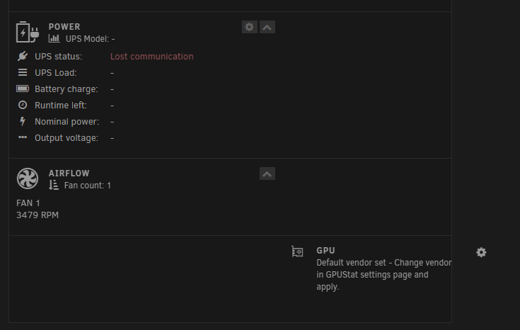

Not sure if this has been brought up yet, but with the new version of unraid the sidebar gets messed up with no gpu selected image.png.8c5fa933fa9b8a84e3e756d0695704c8.png
edit: might be something wrong with my machine?
Edited by mlapaglia
