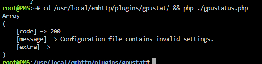

    Good day, plugin also stopped working for me.   root@Unraid:/usr/local/emhttp/plugins/gpustat# cd /usr/local/emhttp/plugins/gpustat/ && php ./gpustatus.php Fatal error: Uncaught TypeE

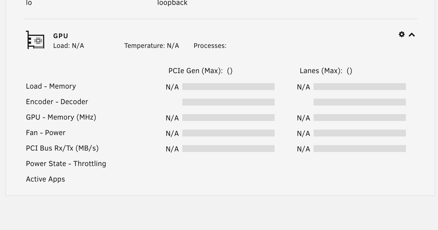

This plugin is gone from my dashboard.
I found it under failed installed plugins, so I deleted it from there.
Tried to download it again from CA, but there is no install button.
Where it usually says install, is says "Pending" now
How can I get this neat plugin back on my dashboard?
Thanks

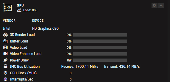

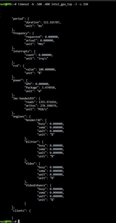

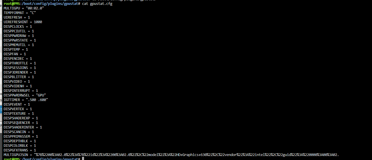

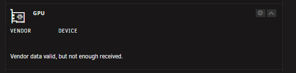

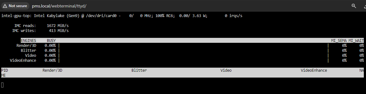

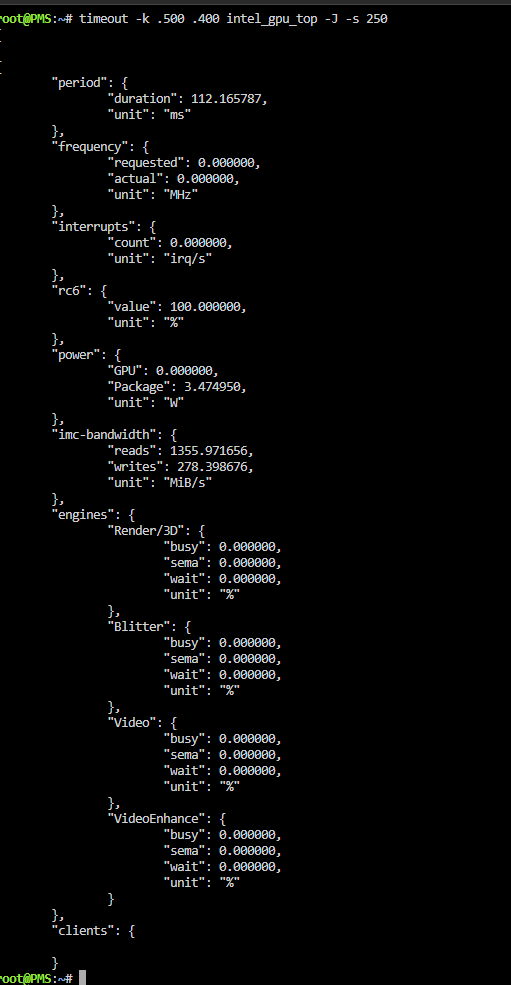

I've been having buffering/transcoding issues and I noticed that my gpu statistics plugin shows "Vendor data valid, but not enough received." most of the time. I tried removing intel gpu top and gpu statistics, rebooting, and reinstalling them, but my issues seem to persist. I'm attaching all of the imagery and debug info people seem to be requesting and would really appreciate help!
The only numbers that seem to change in the statistics panel are the 'IMC utilization' and 'interrupts/sec' fields.
may rather take a look on the Media Server App logs (Plex, Emby, Jellyfin, whatever ...) what it states there and look for the errors happening there while transcoding.
this plugin is just reading the usage and has usually nothing todo with your issues above, so might be the wrong place to ask ...

running gpustatus.php is pre 6.12 can you provide cat /tmp/gpujson
root@PMS:~# cat /tmp/gpujson
Time = Wed, 14 Feb 2024 10:40:44 -0500
{"00:02.0":{"clock":0,"fan":"N\/A","memclock":"N\/A","memutil":"N\/A","memused":"N\/A","power":"0W","powermax":"N\/A","rxutil":"186.29 MB\/s","txutil":"24.97 MB\/s","temp":"N\/A","tempmax":"N\/A","util":"0%","vendor":"Intel","name":"HD Graphics 630","3drender":"0%","blitter":"0%","interrupts":0,"powerutil":"0%","video":"0%","videnh":"0%","vfio":false,"vfiochk":false,"vfiochkid":"0000:00:02.0","panel":1}}
I don't doubt this could be the case. I do feel like people generally have some activity reported on gpu statistics while idle but in my case it's always stark... I assumed my GPU just isn't interfacing with the OS let alone plex. I've tried looking at plex and tautulli logs but honestly I don't know how to decipher much and figured I'd start here.
Edited by picky
This looks correct, it seems to be the output of IntelGPUTop is not providing any info apart from IMC from the other screen shots you have provided.

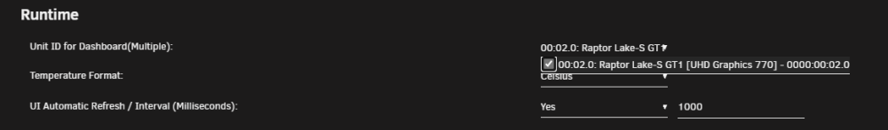

For the "Vendor data valid, but not enough received." folks that are also Intel iGPUs, try this in the GPU Stats configuration UI...
Set (or confirm) that "UI Automatic Refresh / Interval (Milliseconds):" is not lower than 1000.
Set "Intel_top_command_timeout:" to "1 .9"
My system is getting older (Coffee Lake / Gen8) and I've noticed that the stats panel is having trouble when my system is really bogged down.
Hope this helps someone!
