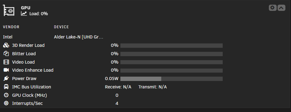

10 hours ago, ich777 said:
But everything seems alright…
You don‘t get every reading on every CPU/iGPU.
Put a load on the iGPU and you’ll see that the values are populated.
Intel iGPUs will show every time zeros when they have no laod on them.
Thats part of the problem I have configured my plex to utilize the but its not talking to the gpu at all.  If you are not seing issues here then I more than likly need to look at my plex configuration. I will start poking around. Thanks for clarifying that what I see is normal.

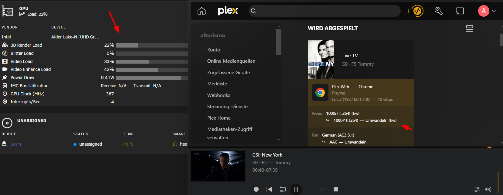

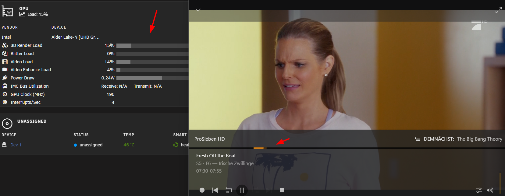

9 hours ago, alturismo said:
actually probably not ;) its like @ich777 mentioned, there is a "idle" and a "usage" on the iGPU, by default nothing is using it for real and you wont see any activity.
sample idle here
sample Plex web usage here, while encoding

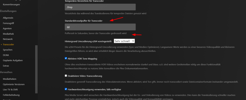

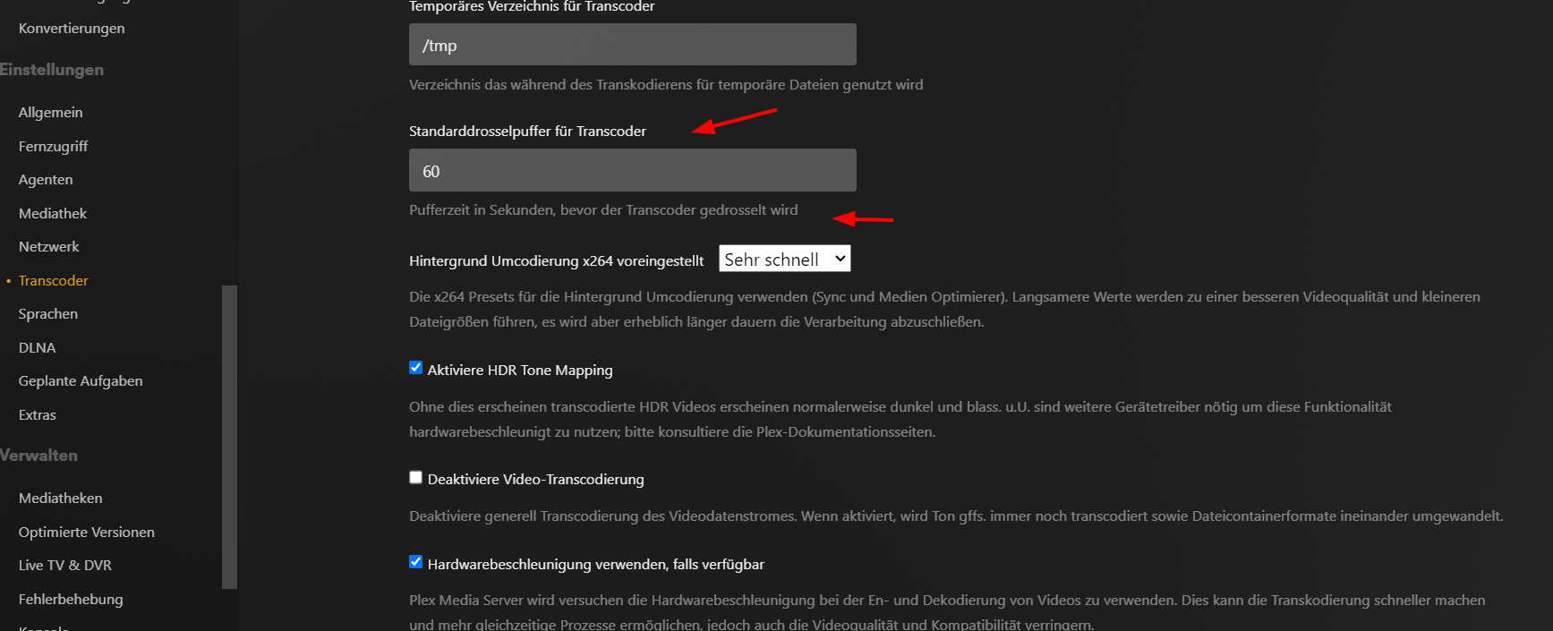

but before you wonder why its not steady on load ... media servers are "buffering" and pre rendering
sample, when you look at the bar you see the "buffer"
and the gpu load will drop as its working in "waves" ... so dont wonder about it, normal behaviour and also depending on clients buffer behaviour, how your Media Server Software is setup and so on ...
sample here, after 60 seconds it will throttle here as i dont want to have the full media pre transcoded (if possible, local media could be pre transcoded, live tv like the sample couldnt be pre transcoded anyhow ;))
i hope it makes it a little clearer
It does thank you for the claification. I noted in my other response I think its a configuration issue on my end with with my plex container. I am going to rip into that now and see if i missed anything. Thanks again for the support.

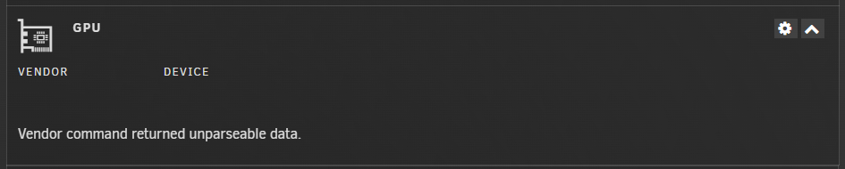

Since updating to the latest plugin release GPU is no longer showing on the dashboard.
image.png.4384cd5b4dd7d1b7837da58cca3544ed.pngTried to uninstall it and re-installed but no change. Any idea?
Please post your Diagnostics.

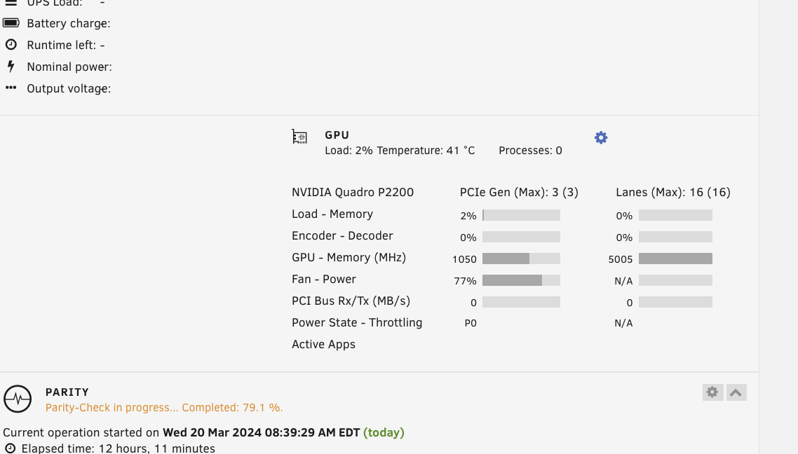

why is the data in the tile right justified ?
698272933_ScreenShot2024-03-20at8_51_33PM.thumb.png.2e47141b901c37c0808056a9e9b4e87d.png

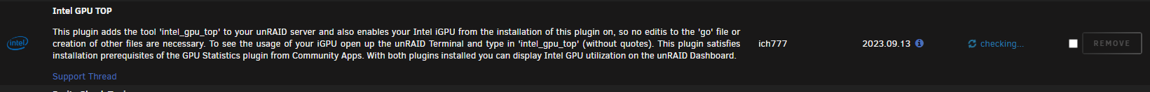

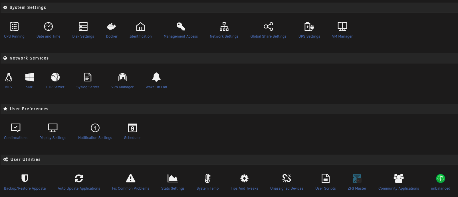

I only just installed this for the first time, as now I have a CPU that can do this (quicksync), but nothing on my dashboard like the pictures here.
Did you configure the plugin in your Settings tab within Unraid?
If you have further issues please post your Diagnostics.
I cant see anything in there for this :
Diagnostics?
Are you sure you‘ve installed the plugin from the CA App?
I have no idea how to do it any other way........

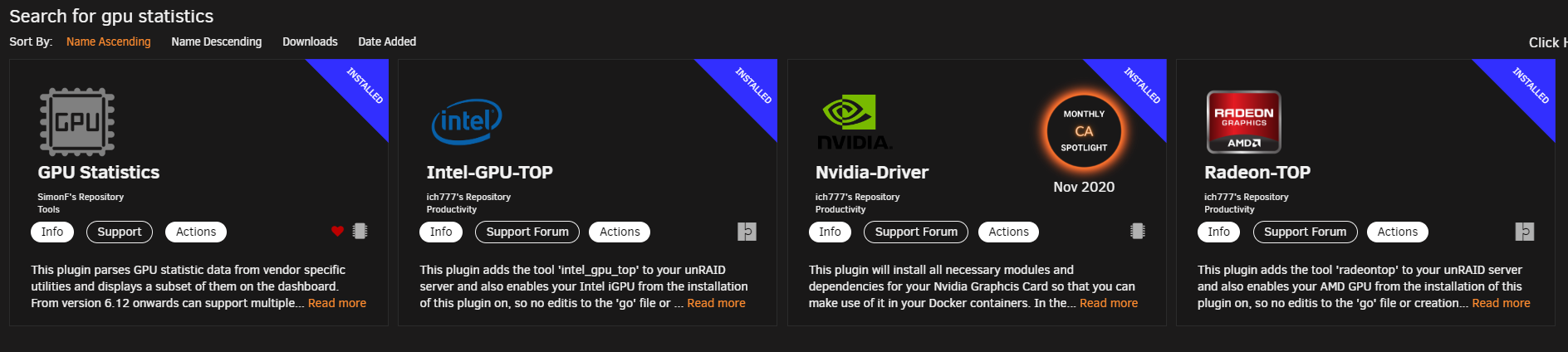

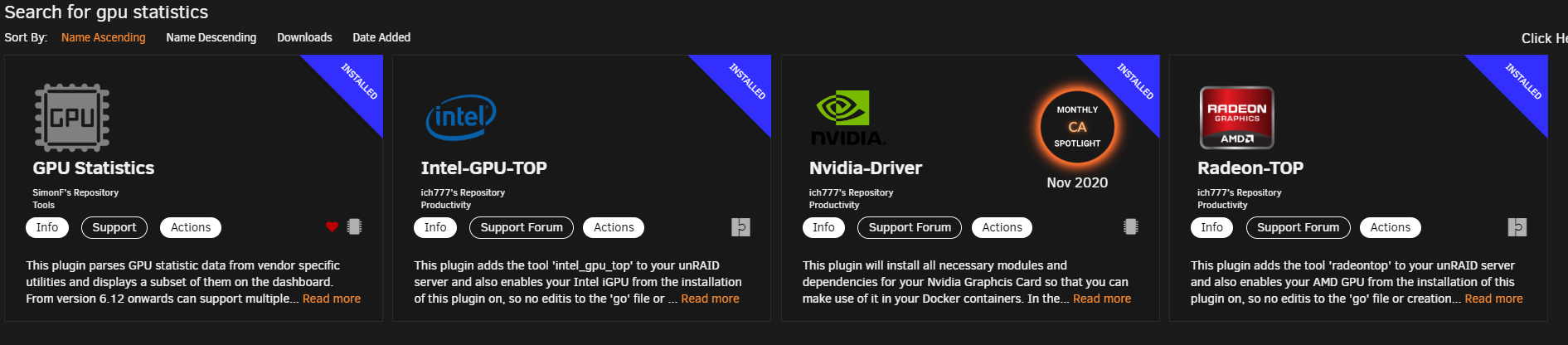

You‘ve installed Intel GPU Top and you are in the support thread from GPU Statistics…
I hope you are see where I‘m going with this.
You are missing GPU Statistics.
You‘ve still didn‘t upload your Diagnostics where that would be obvious to see.
Maybe because you are using the older version of GPU Stats that is not 100% compatible with 6.12+
You need to be using my version from CA.
As ich777 said you need to install the gpu stats plugin + the corresponding driver package which you already have installed.
Oh - what a knob I am!!!!!!!
