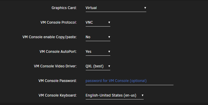

@ich777 @SimonF I noticed now that when I shutdown my Win10 VM, the GPU statistics became visible. Can you please check again my previous diagnostics if there are conflict with Windows VM? Thanks. image.png.52fa775efee48f49566521ae0867df3a.png
My VM graphics card config is as follow:
Edited by HHUBS
Can you post new diagnostics, do you have the igpu defined inside the VM?

I have no igpu define in VM as seen on my screenshots. Here is the new diagnostics with the Win10 VM shutdown. Hope we can find the root cause of this. Thanks.
hhubs-diagnostics-20241222-0603.zip
I cannot see any thing obvious, You do have the onboard audio device on pci 1f.3 passed thru. Have you always had that?

EDIT:
@SimonF I removed the audio and start the VM and then this again.
Edited by HHUBS
On 12/20/2024 at 1:47 PM, ich777 said:
Can you please provide a bit more information, it is working just fine for me.
Please maybe also post your Diagnostics.
When I installed the Intel GPU TOP plugin, I can now display GPU work normally. thank you.
@ich777 @SimonF I think I have solved my problem. My problem, if you can remember, is connected with virtiofs. When I removed that from my VM config, the GPU stats are back. Been running good now for 10 hours and still ok.
Strange not sure why Virtiofs would break igpu unless it is memory related.

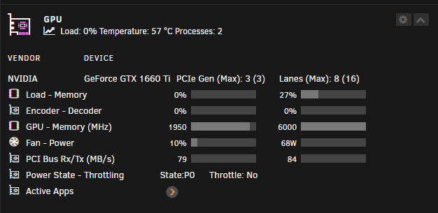

Recently upgraded unraid to 6.12.14 and updated the gpu driver to 565.57.01. Now the GPU statistics does not show the icon for a docker that is using the gpu. Code Project AI docker runs 24/7 but never shows under GPU statistics. My plex icon still works.
