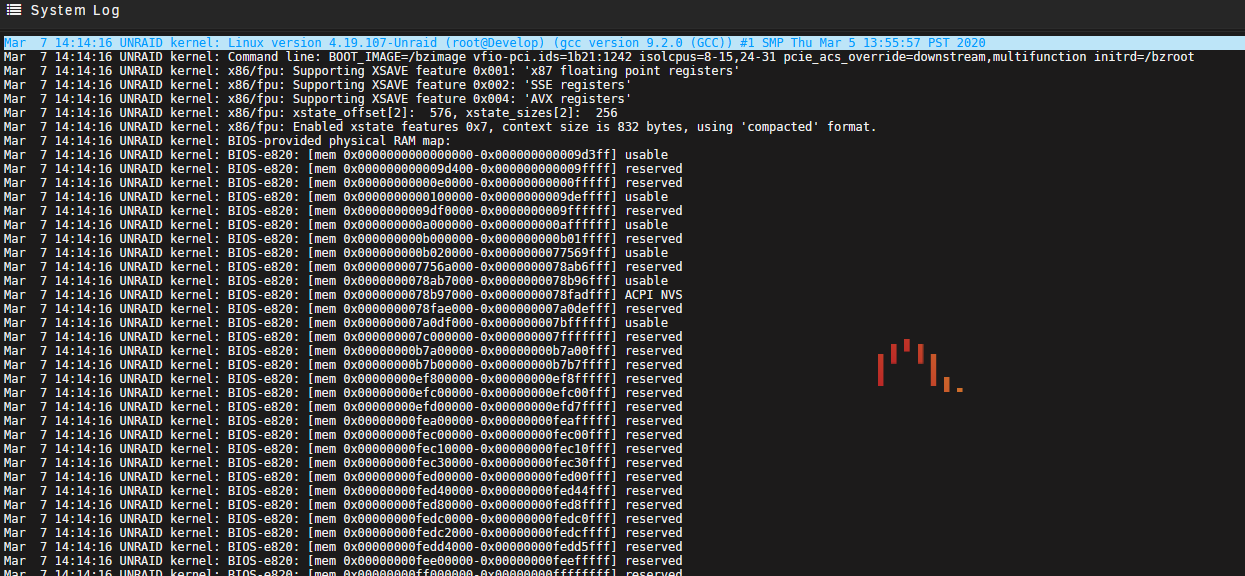

Update from 6.8.2 went fine so far. Unraid is back up runing with all VMs and Dockers. Small thing i noticed is by opening the "system logs" under tools the orange animated loading stripes showed up for split second and dissappeared. Not happened before and doesn't look like it has any impact. Maybe only a small glitch.
