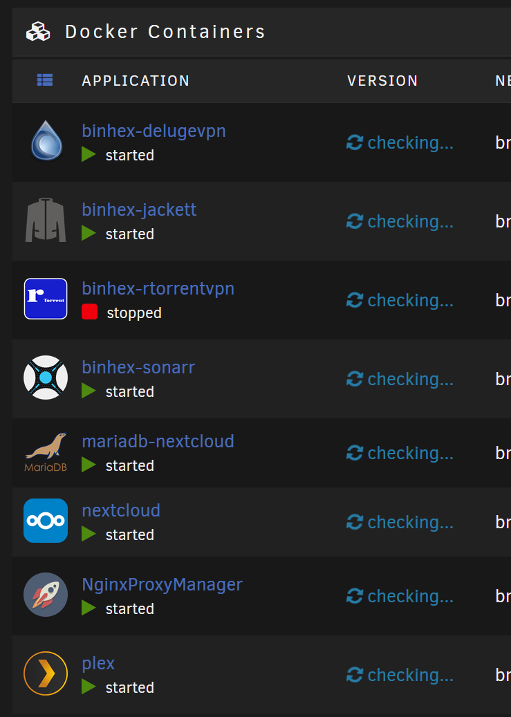

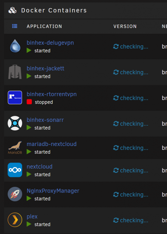

2 hours ago, bonienl said:
Click on "Check for Updates" to get the up-to-date status.
Tried that - it says "checking..." in blue but just spins forever - when I refresh the page it goes back to "not available"...
Edited by SliMat
This is not really the best section to discuss this, but something is blocking your access to github.
Are you using pi-hole as DNS server for Unraid? Or some kind of VPN tunnel to connect to the Internet?
Thanks @bonienl
No, the only VPN I am using is in delugeVPN / rtorrentVPN - not using a VPN or proxy server. I'll roll back to 6.8.2 and see if it clears then post as a possible bug - just thought someone else may have seen this and found a fix.
3 hours ago, SliMat said:
...just thought someone else may have seen this and found a fix.
OK, just in case anyone else see's this - I just used force-update on one of my dockers and now it shows as up-to-date... so will force update on all the others too.
Edited by SliMat
spelling
