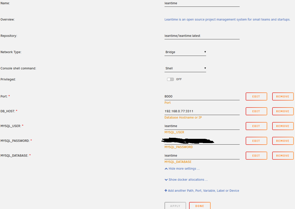

So I tried to get your leantime package up and running. But I have no idea why it's not working.
I think I set up mariadb correctly since I've done it plenty of times with nextcloud, mattermost and others.
I just don't know how to fill out this template.
This is how I did it:
What am I doing wrong?
its because DB_HOST should only be ip or hostname
it default to 3306 which what mariadb or mysql use
ill try to add the DB_PORT add variable for now DB_PORT and put 3311 on it
yeah leadtime dont have variable for database or im not sure cant find it
will try to make issue
Edited by A75G
So if I understand correctly. The mariadb needs to be on port 3306?
I also noticed that there seems to be no AppData Config Path in this template. Can I simply add one or does this have to be done for the template?
Thank you very much for helping!
I edited my last reply
for appdata path there are none on the docker-compose so it not needed https://github.com/Leantime/docker-leantime/blob/master/docker-compose.yml
Edited by A75G

I switched both the mariadb as well as the leantime dockers to theri own br0 ip adress. Of course you'll have to  point them at each other in the templates.
Then it just worked.
Edited by Heciruam
APP Leantime
Had Leantime running just fine when suddenly it stopped working with database connection problems. Tried some of the suggestions here with the port number with no success.
After some investigation I figured that the version, which was updated to 2.1.1, caused the trouble with the database connection.
Solution: Change the Repository to “leantime/leantime:2.1”
This will pull the version 2.1 (obviously) and no further changes are required.
BTW putting the database port number after the DB_HOST works without problem. 192.168.10.15:3307 as an example.
Hope this helps someone else in the community.

Something like that if its letsencrypt dont forget to change it to custom network with letsencrypt
Okay, that worked perfectly. Thank you very much. I have spent quite some time trying to get a volume mapped for this, so the configs can persist. I tried having a mount like:
/var/www/html <--> /mnt/user/appdata/leantime
However, I just ended up with an empty /var/www/html. I also tried /, /config, /var/www/html/config, but none of them worked. I want to persistently store SMTP settings in the config file. I am not seeing any environment variables I can pass to the container to run these configs. Does anyone have any thoughts on this? Am I just missing something stupid?
7 hours ago, thraxis said:
They've added volumes to the docker now... the template is broken again.
ill l update it now hopefully smtp problem is solved too
Edit: i added the volumes but there is new issues so ill revert it to 2.1.1 and wait until it fixed https://github.com/Leantime/docker-leantime/issues/20
Edited by A75G
