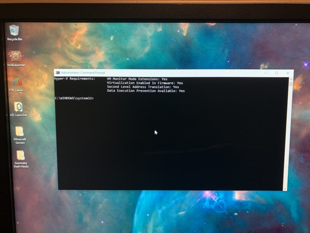

Ive looked at all the Bios settings and the setting is just not in there. But when I go to Windows System information it says IOMMU is enabled. It’s just that the GPU doesn’t want to pass through the VM and be detected.

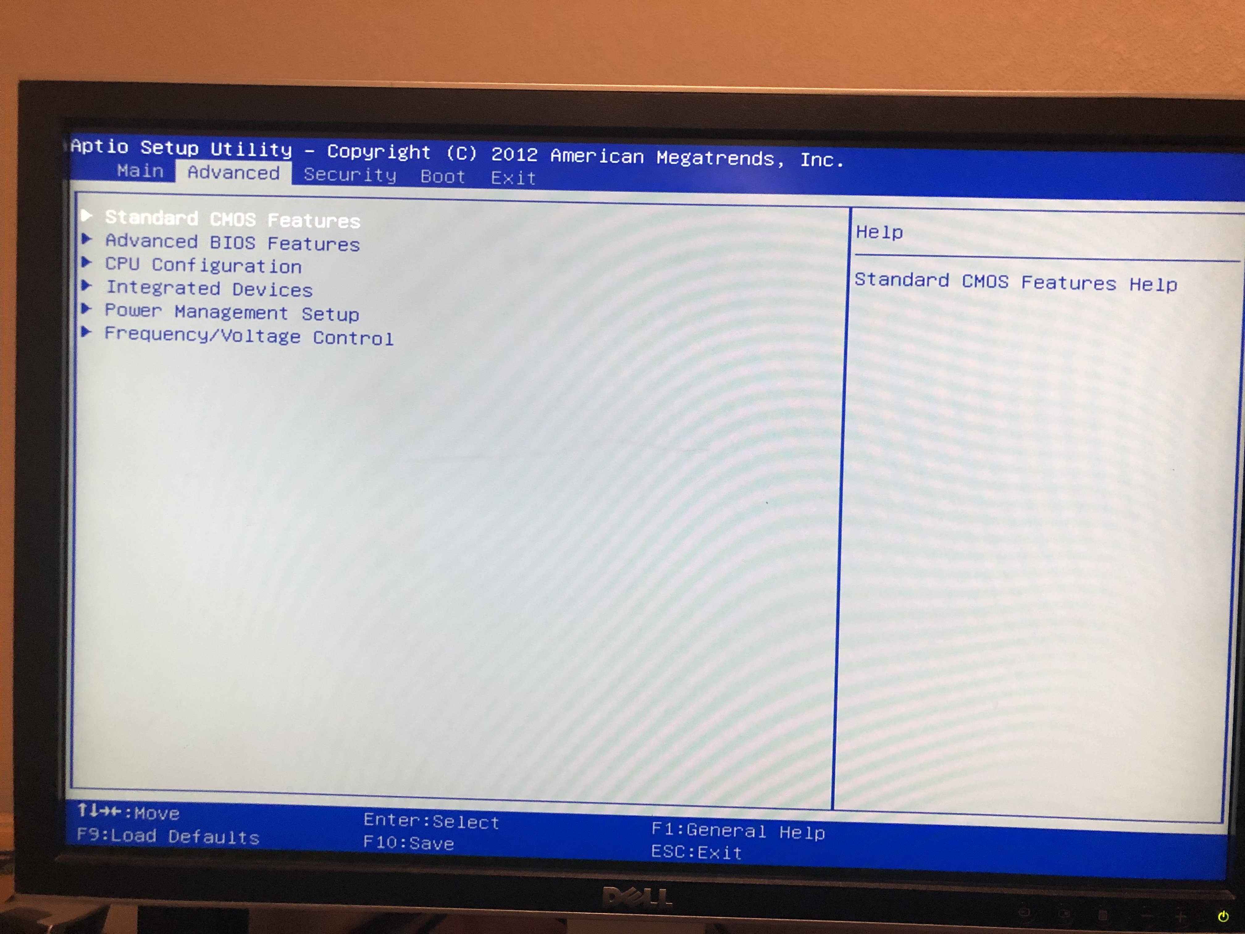

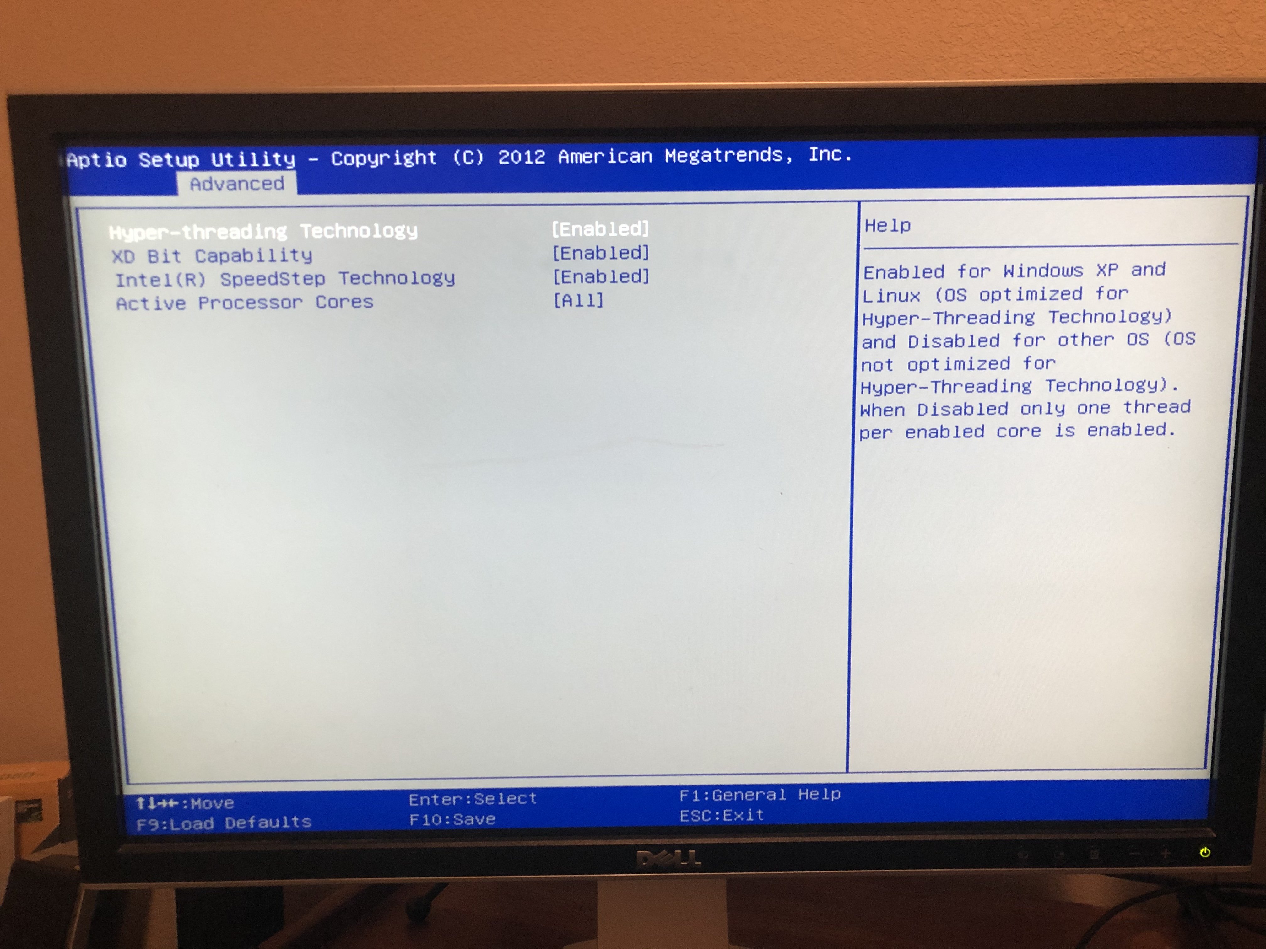

I’m showing here that the option isn’t Available in the Bios and that virtualization is enabled. According to these photos it should let me pass hardware (GPU) through my VM if I’m not mistaken.
Its possible it is that Dell stripped that option out of their BIOS...  Check to see if there is a BIOS update
Check every entry for something that looks like VT-XVT-D, and Virtualization Technology.  They all need to be enabled.

I looked trough the whole bios and found nothing regarding virtualization.

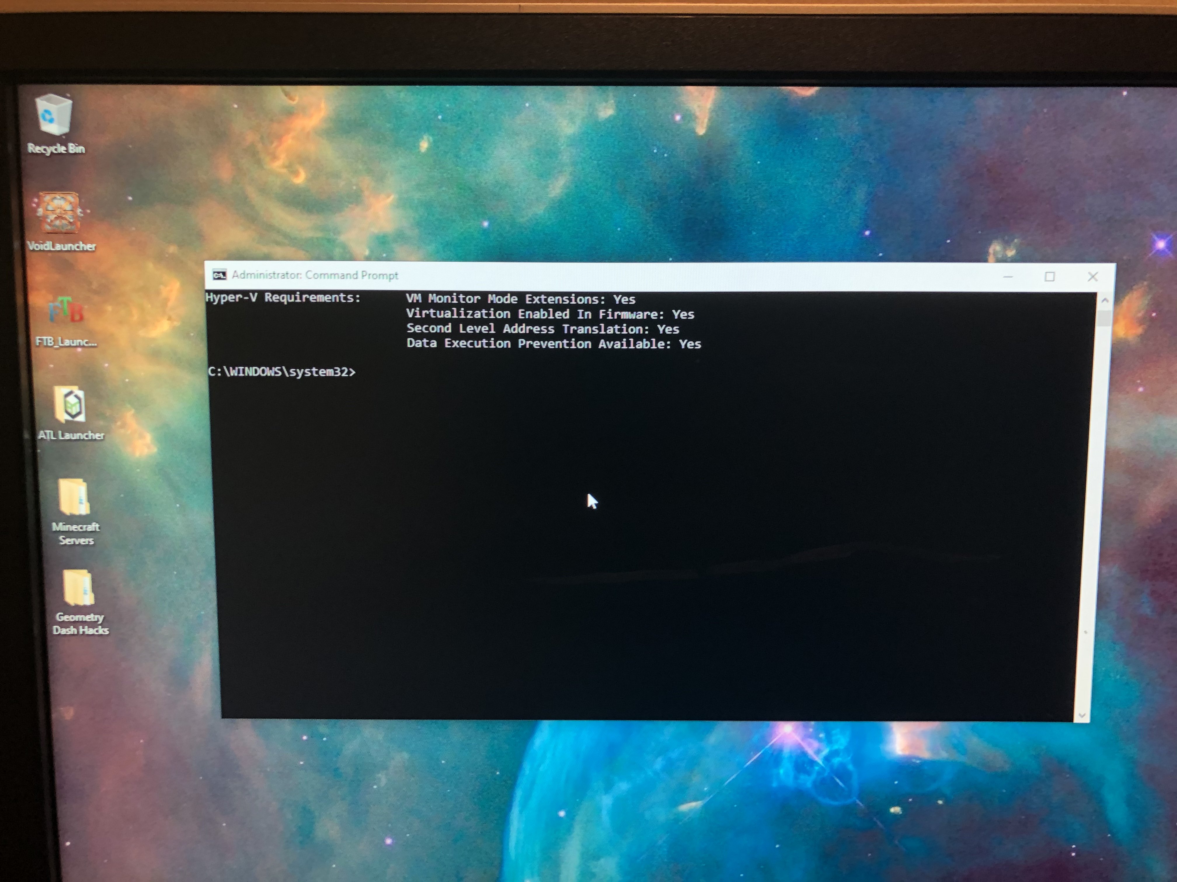

But when go to my system information it says “virtualization enabled in firmware: yes” As I showed in the photos.
So shouldn’t it already be passing hardware through the VM?

The way i read all those screenshot is that vt-d is not enabled.   Only vt-Xml
