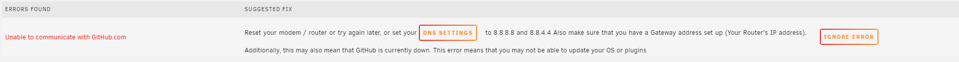

According to the CA "Fix Common Problems", my DNS keep being messed up.

If I restart the server, "Fix Common Problems"'s issue with the DNS, is gone at first, but comes up again after 5-10 minutes, or if I scan with it.
Any ideas why?
If I change the DNS to Google primary (8.8.8.8) and secondary (8.8.4.4), and Cloudflare (1.1.1.1) as the third, and scan it with "Fix Common Problems", it still thinkgs the DNS settings are messed up.
Does anyone have an idea of what I can try?
It's not that FCP thinks that the DNS is messed up, but rather that it can't communicate with the outside world (in this case GitHub) which is a necessity for many subsystems within unRaid.  The DNS suggestion is simply a suggestion as that's the most common problem for this issue.
