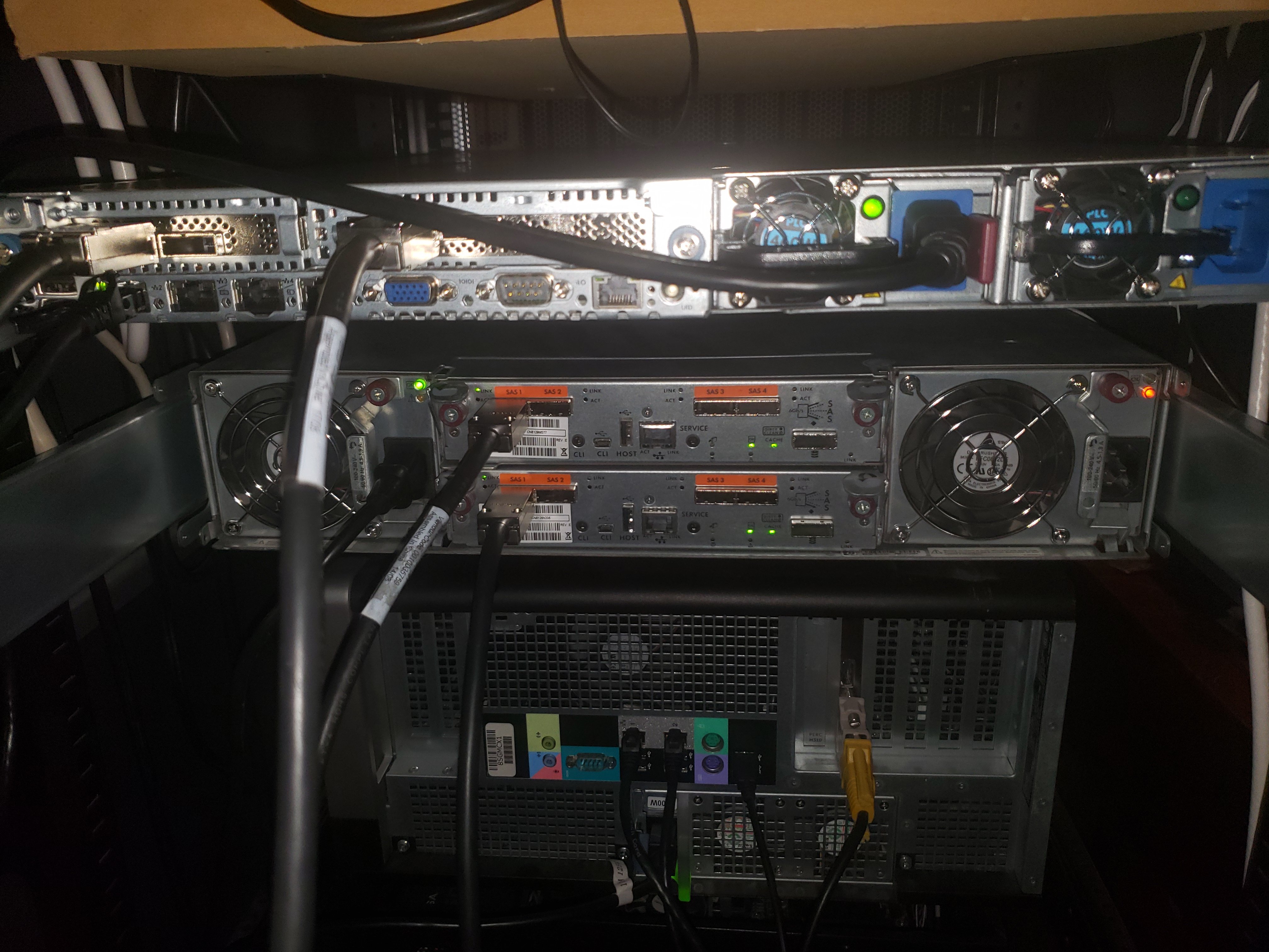

I have connected two of the SAS ports between the server and the SAN. (See picture 1)

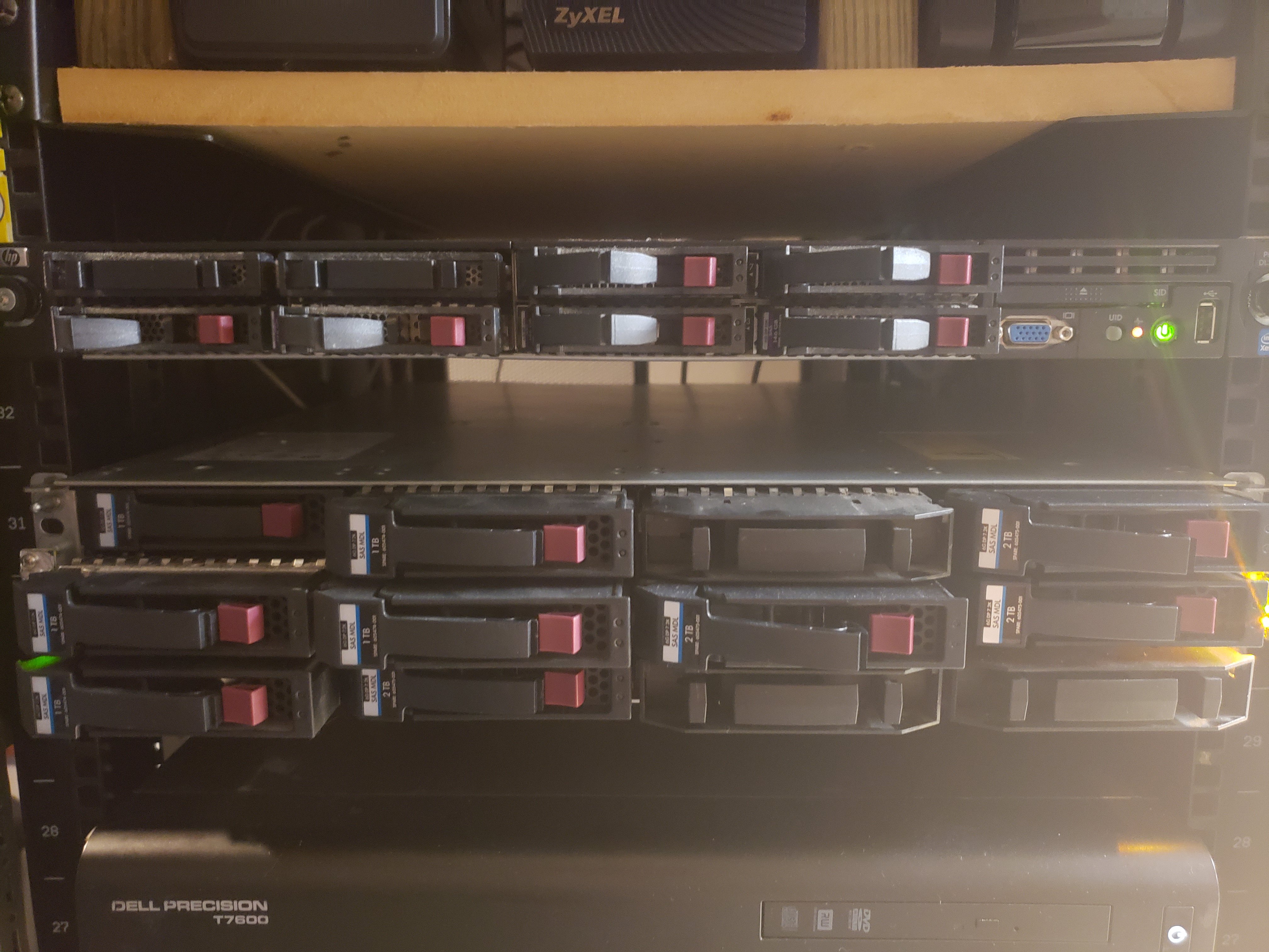

I have then connected only 1 of the hard drives in the SAN. (See picture 2, upper left on the SAN, none connected on Proliant)
I have gotten Unraid started on the Proliant but I am unable to see the hard drive on the SAN.
