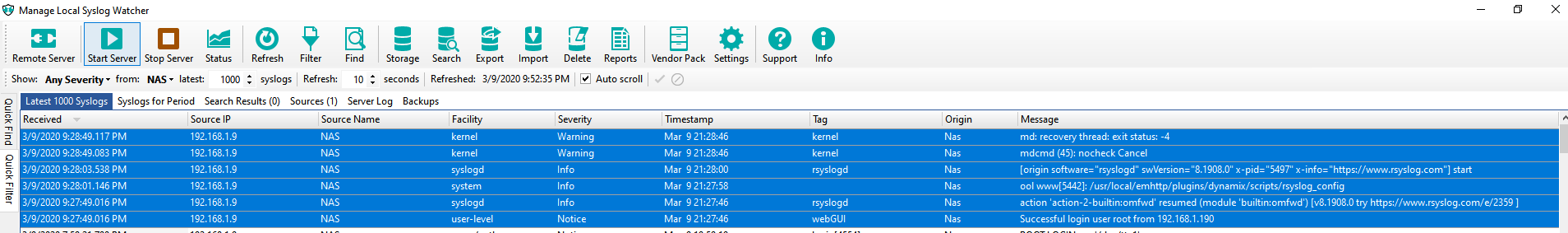

The system crashed and I have attached the syslog and the screenshot from remote syslog server.

The syslog you attached to this post ended 10 minutes after the server restarted.  But there are a lot of the following entries in the syslog.  @bonienl, could you have a look at this:
[v8.1908.0 try https://www.rsyslog.com/e/2007 ]
Mar  9 22:08:07 Nas rsyslogd: action 'action-3-builtin:omfwd' resumed (module 'builtin:omfwd') [v8.1908.0 try https://www.rsyslog.com/e/2359 ]
Mar  9 22:08:07 Nas rsyslogd: omfwd/udp: socket 2: sendto() error: Network is unreachable [v8.1908.0 try https://www.rsyslog.com/e/2354 ]
Mar  9 22:08:07 Nas rsyslogd: omfwd: socket 2: error 101 sending via udp: Network is unreachable [v8.1908.0 try https://www.rsyslog.com/e/2354 ]
Mar  9 22:08:07 Nas rsyslogd: action 'action-3-builtin:omfwd' suspended (module 'builtin:omfwd'), retry 0. There should be messages before this one giving the reason for suspension.
