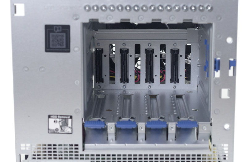

The N2 seems to have a separate compartment for HDDs, too, and the case fan seems to pull air right through this compartment (well, obstructed somewhat by the HDD-panel). But no-one actually went into depth there - That's why I ask for practical experiences (like the linked post you kindly provided, thanks!).
Yeah, I'm not aware of any reports on the side-by-side HDDs temp tests that've been done between those cases, with same or similar sets of drives, under same conditions.
I'd argue the the N2's HDD backplane is the biggest air-flow restricting factor.
The 304 doesn't have any of that.
I've also heard of some users actually removing backplanes to open up their N2s in order to reduce HDD running temps.
There's also one more downside to backplanes - they're just another point of potential failure.

I understand why it is likely to be true. I am not sure of the 304 is much better, though (but maybe that's a good question for a separate thread).
Actually, it looks like the N2 has some space between all hard drives, and the backplane PCB has some cut throughs, and the guide rails are lined with holes to draw air in. Granted, this is pretty indirect airflow, but the fan seems to pull air out right behind the PCB. It's a 15 mm thin version, though, due to 10 mm missing depth - which seems to be the N2's major design fault, according to this review (at 3:50...6:15). I linked a report to modifications in a post before that componsates that (or, I saw someone mention you can mount a Noctua 12x25 mm full thickness fan outside). Also, at least one of the double mesh filters should be taken out or substituted with a wire cage. The separate MoBo compartment seems not to have a separate cooling fan in the case, but it has holes in the top to draw in air with an active CPU cooler (which my preferred board has). Most case openings seem to be covered by mesh, but that could be taken out (not sure of this would be a new problem).
The Node 304 has only space in the middle of a set of two drives, with covers around each set and a full opening to the bottom. It also has a small slot on top and bottom to let air in (instead of an open front like the N2). It has two more fans pushing air there, so maybe the more active cooling is what makes this concept better - although many people suggest to exchange them all for more powerful aftermarket fans. But poor room for cable management and other stuff can make the case pretty crowded and obstruct airflow. This guy explains in a video that his 2.5 SSD builds overheated, so he made a massive effort in 3D-printing and grinding the case to include a 140 mm fan in the front (I do not know why he covers it with thin mesh, then - but it seems to work). The CPU seems to be in an area that is not affected much by airflow - but at least, the sides seem to have holes in that area for the CPU cooler to draw in air.
But I suppose all that is theory.... So I am really unsure - It seems, the 304 is somewhat more closed and less organized in design, and comes with more and louder fans to compensate (which are recommended to be switched out). I do not want to grind around the frame and print a new front for a great, massive 140 fan). The N2 has the backplane PCB. And I agree, a PCB between MoBo and drives is an additional point of failure in the electronic leads. Actually, taking out the backplane and losing the hotswap capability is an additional option if things do not suffice.
And clearance wise, even the 304 is almost 37.5 cm deep - I agree, this is not much difference to 39 cm of the 804 (which is wider and higher, too, but that would not be my problem). The 22.4 cm of the N2 is significantly easier to fit in a shelf...

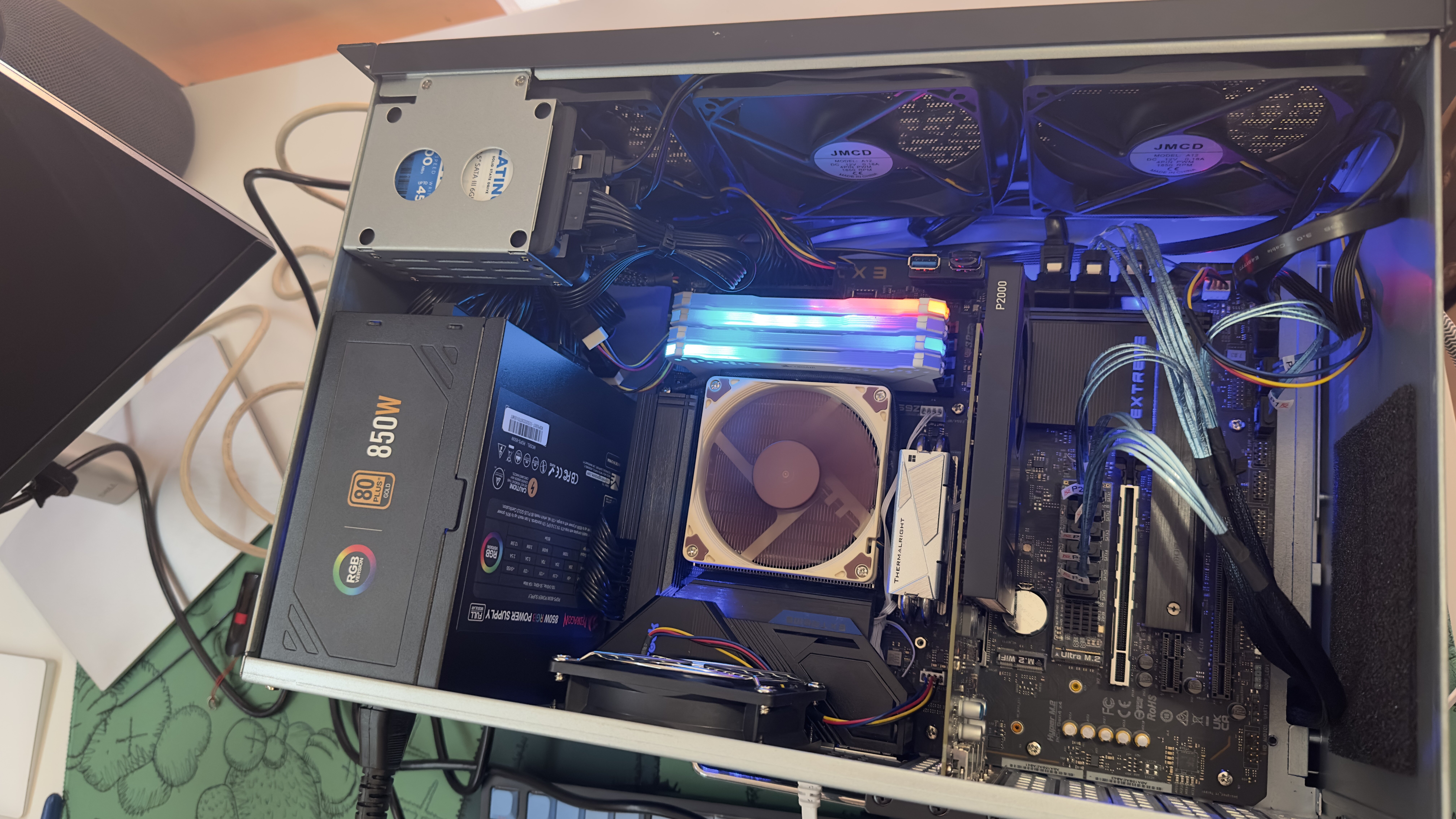

I have just moved my server from a Silverstone CS351 to a Sagittarius 8-bay enclosure.
The CS351 is pretty but a thermal time bomb for the hard disks. That's why I got the enclosure from Aliexpress, which is hardly available here in Europe.
The enclosure is not expensive but worth the price. Since I only use 4 of the 8 bays (probably soon 5) there is enough cooling air. I control the 2 120mm Noctua fans with a dedicated controller from Aqua Computer.
There is another 120 mm fan in the mainboard area which is controlled by the mainboard.
The system is an i3-13100 with 64GB Ram and 2 NVME disks. An Intel x710 10 GB network card is also installed.
The case only has a front USB port and a power button. No LED or similar. The hard disks are inserted using rubber buffers and are therefore damped. The front of the hard disks can be removed without tools and disks can be changed during operation.
The delivery time was 4 weeks to Europe and the price €130.- including shipping.
The black adhesive strips in the area of the hard disks are aluminum butyl for damping the housing. They were glued on by me.
Aliexpress Sagittarius 8-bay nas
-faxxe
