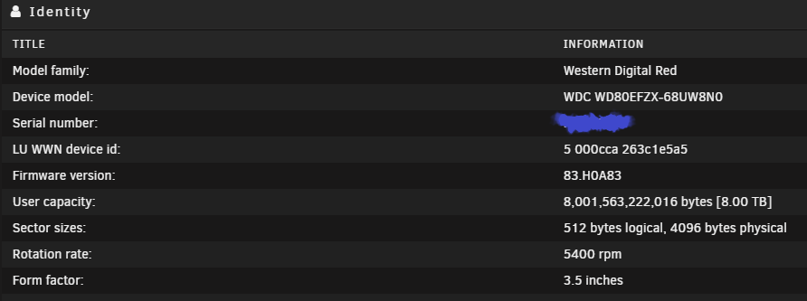

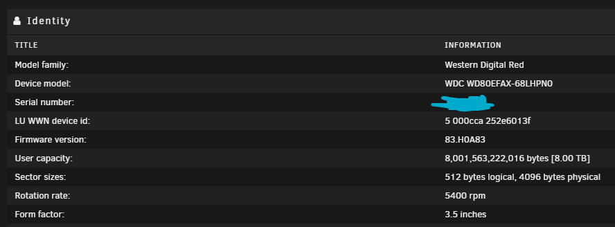

Just found online that the Dell Perc h310 doesnt work with all drives. Not sure what it means but "Perc H310 works with 512n/e and not 4kn drives". I dont know what I have though.
Edited by ssh
That refers to the sector size on the drive.  It has nothing to do with the drive itself, just how it is formatted.  You should not have a problem with drives formatted in unRAID.  All of my drives work without issue with the Dell H310.
Here's a snip from one of my drive properites.  Notice that it has 512 byte logical sectors even though physically it has 4K sectors.  This is 512e (emulated).
Here's a snip from one of my drive properites.  Notice that it has 512 byte logical sectors.
https://www.datacore.com/blog/stories-from-the-bit-shift-or-what-means-512n-vs-512e-vs-4kn-vs-flash-pages/
A thanks, mine says that as well :)
