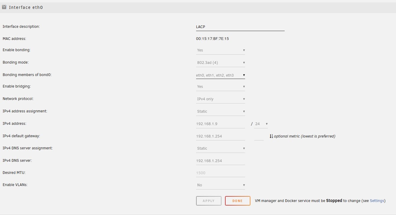

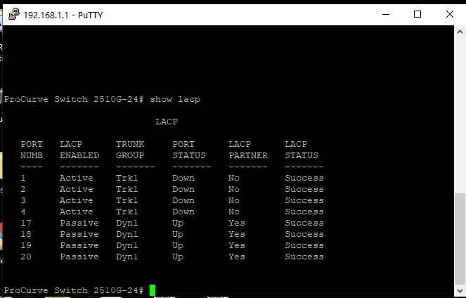

I have set up my unraid server with a quad intel NIC card which is connected to a HP Procurve switch with 4 cables. I think I have the switch configured right. I have tried active and passive on the switch. I can read from 2 different clients at full gigabit speeds, but when trying to write to the server it only writes at a total of 1 gigabit speeds split between the 2 clients. I have a SSD cache drive so that shouldn't be the issue. Any ideas where I'm going wrong. Thanks.
Writing to the server means it is your switch which has to balance traffic over the LACP channel.
So it's my switch that I have configured wrong then. I'll have a play with that then. Anyone know exactly how to do it on a HP Procurve? Thanks.
