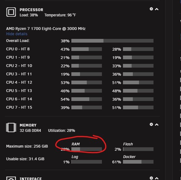

RAM is stuck at 100%
Where are you seeing this?
on the dashboard. picture attached.
