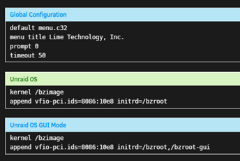

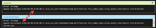

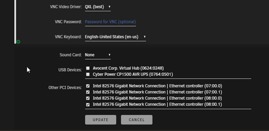

I have 4 NICS as part of the server and have added another Intel 4 port NIC for PF Sense.
I entered the vfio command in Syslinux Configuration to remove the new card from Unraid.
It was successfully removed and it turns up on the PF Sense config to include.

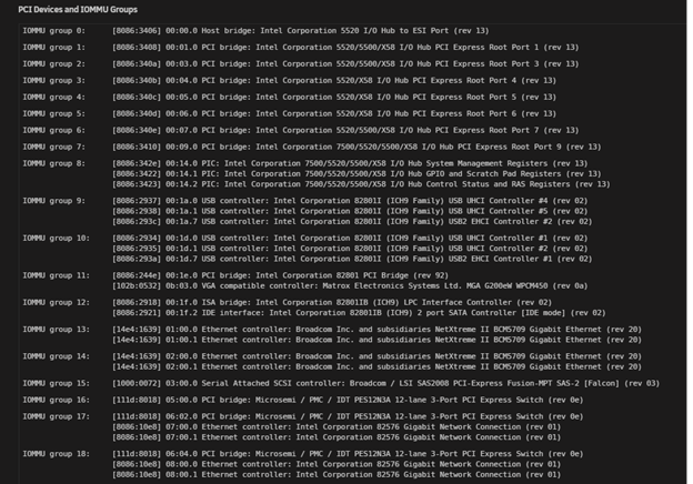

IOMMU screen

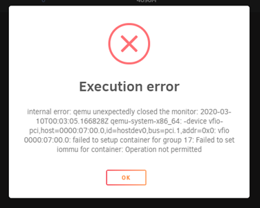

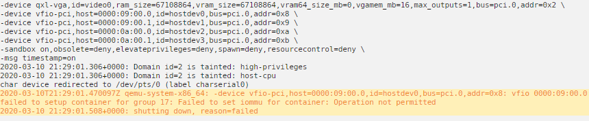

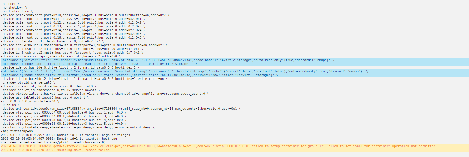

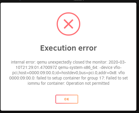

When I try to start it up, after removing virtual disk in XML, it gives this error message:
Error Log:

I'm out of ideas. Anyone else get something similiar?
I tried a few of the other suggestions in the forum but no joy!
Could someone have a look at the particulars and suggest a direction to head in?

3.       Go to Tools/System Devices. It will provide a list of devices in your machine. Look for your ethernet adapters. I have 4 – but only need 2 so I used device 02:00:00 and 02:00:01 leaving the first to for Unraid to use. Jot down these numbers.
4.       Go to Main/Flash and scroll to the bottom. Add the text shown
Note where I used 02:00:0 and 02:00:1
Reboot the machine as these commands affect the entire machine and need to be in play for the next steps.

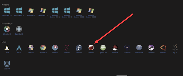

5.       After reboot, go to VM tab in Unraid and click “add a VM”.
6.       Choose FreeBSD

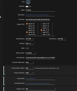

7.       Fill in the template as shown in the attached “Tutorial PF Sense property sheet.PDF. Click on the yellow bubbles for additional info.
Double check to make sure the “start vm after creation” is unticked.

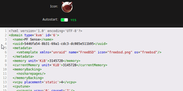

8.       Click on the VM and select edit.
9.       In the top right there is a button that says “form view”. Click it and you should see something like this. (XML)
10.   Scroll down to </video> near the bottom.
11.   Add in the following text after </video>:
      <driver name='vfio'/>
      <source>
        <address domain='0x0000' bus='0x02' slot='0x00' function='0x0'/>
      </source>
      <alias name='hostdev0'/>
      <address type='pci' domain='0x0000' bus='0x03' slot='0x00' function='0x0'/>
    </hostdev>
      <source>
        <address domain='0x0000' bus='0x02' slot='0x00' function='0x1'/>
      </source>
      <alias name='hostdev1'/>
      <address type='pci' domain='0x0000' bus='0x04' slot='0x00' function='0x0'/>
    </hostdev>
Edit lines 4 and 12 – insert the device id’s from your machine that you wish to use. The supplied example is from my XML and note the usage of the 02:00:0 and 02:00:1 identifiers. Also, if you have more than 2 just add more.

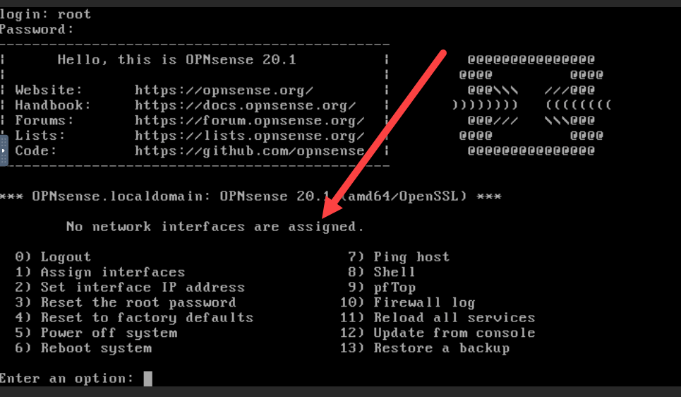

PFSense has major comparability issues with KVM, I always suggest just using OPNSense as its basically identical and doesnt have any problems. Just use I440fx, seabios and it works fine with the latest everything and even virtio drivers.
Ok thanks for the suggestion.
I did actually try installing OPNSense but without the seabios and  I440fx.
I will try that and report back.
Well I tried your suggestion and I got the same result..... this is a really frustrating problem .... but I absolutely will not give up ...grrrrr😈
Looks like the same issue. IOMMU group 17 and 18 are where the newly installed NIC appears.
When I look at settings/network the installed card does not show up (it did) before I executed the vfio-pci.ids= command in the flash drive.
So it appears the card is properly excluded but the VM is not picking it up..... apparently you have to have an available NIC in order to start and install the VM.

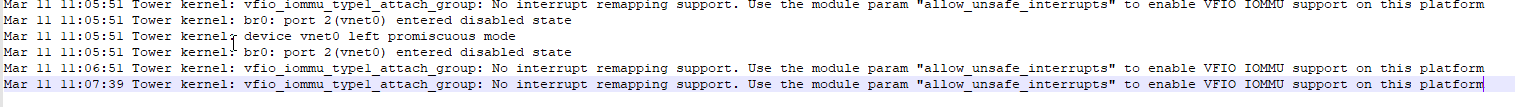

Well, a little more info on the problem:
The kernel error log states:
It tells me to allow unsafe interrupts to clear the problem of "no interrupt remapping".
Does anyone know where I can find the VFIO syntax listing?
I have added the following to the flash drive kernel settings:
kernel /bzimage
append intel_iommu=on vfio_iommu_type1.allow_unsafe_interrupts=1 pcie_acs_override=downstream,multifunction vfio-pci.ids=8086:10e8 initrd=/bzroot,/bzroot-gui
OR
kernel /bzimage
append intel_iommu=on vfio_iommu_type1.allow_unsafe_interrupts pcie_acs_override=downstream,multifunction vfio-pci.ids=8086:10e8 initrd=/bzroot,/bzroot-gui
Neither works to solve the problem. Note the missing "=1" in the first set of lines.
I have included my complete IOMMU list - the added 4 port NIC is in found in groups 23, 24, 25 and 26.
If I could find the syntax options perhaps there is another setting I'm missing or there is a syntax error in the lines.  ¯\\\_(ツ)_/¯
