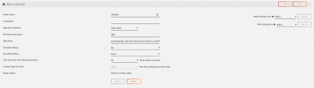

Regarding the split level, I have no clue if I am doing it correctly or not :(. I went to the wiki, it’s in plain English, but it’s just going over my head as I thought I was doing it correctly but after seeing what data in 1-drive only, I wanted to reach back out here and ask. Does the split level mean it saves the same files to all the HDD? My structure is:
SHARES NAME (Movies)
  >> Movies.HD
      >> the matrix (folder)
           >> the matrix.avi (file), the matrix.srt (file).

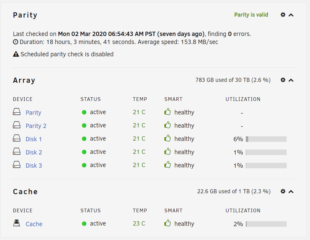

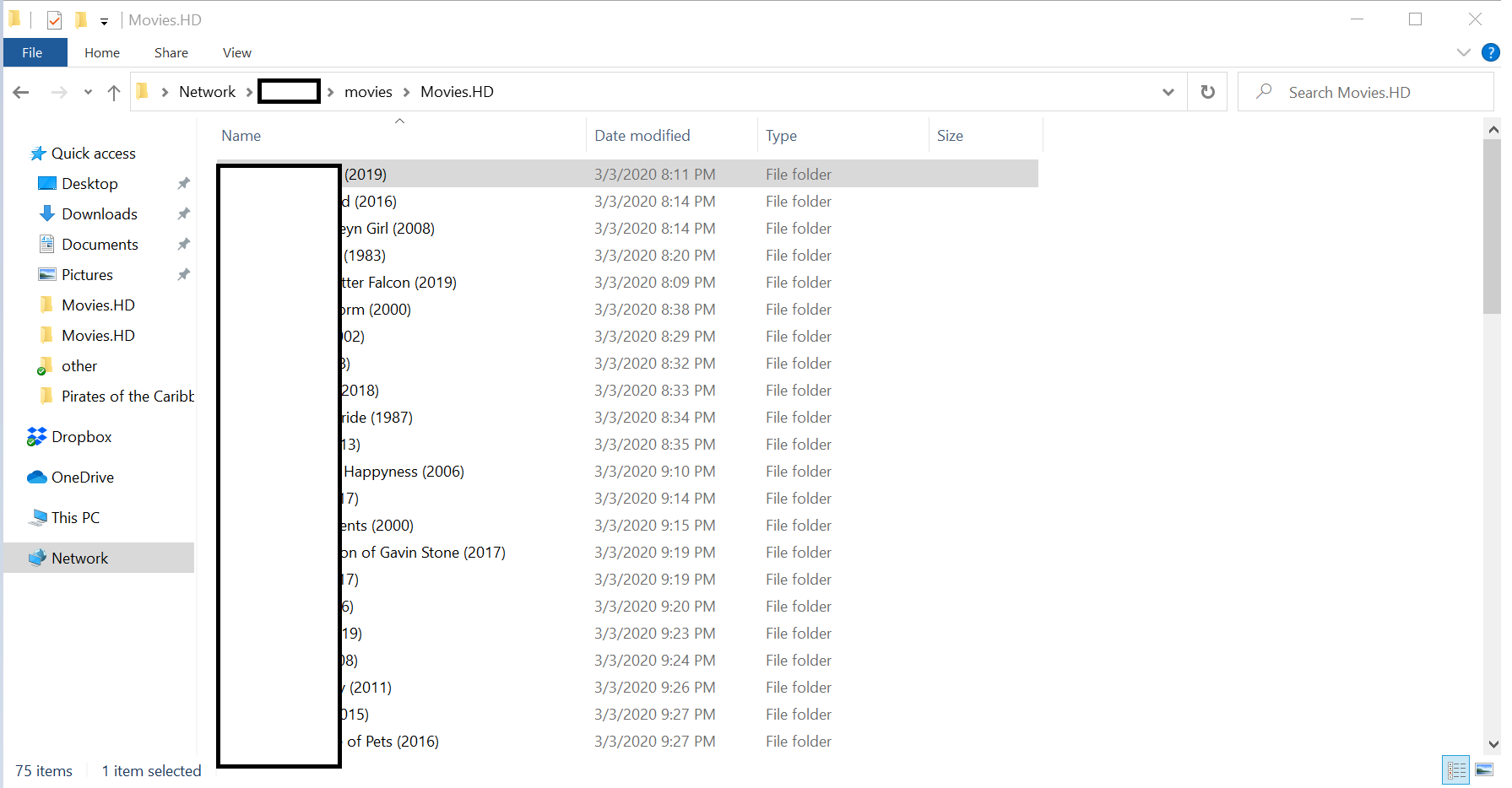

For this, I am using Level Two as in my mind, it places Movies.hd and UP in every HDD, and then the folder of the movie and the files inside together in the same HDD. But any other movie will be placed in another HDD but with all the files inside in the same HDD correct? I took some pictures of it not actually working that way. It seems all the files are going just in 1-HDD alone :( Not sure if that's fine or if that is bad and it should be spreading the MOVIE FOLDERS between the 3-HDD I have.

Your discussion of split level is getting sidetracked by a different misunderstanding, Allocation Method. The default Allocation is High-water, and it is default for a good reason. It allows a user share to use multiple disks "eventually" but without constantly switching between disks. It will fill the first disk until the "high-water" mark is reached, then it will move to the next. Actually, it is a little more complicated than that, but that is the basic idea.
This sounds like you think maybe it makes copies of each file on all the disks. This is definitely not the case, but maybe I misunderstand you.
You are 100%, I might have the wrong concept of this :/
According to the info you provided, all my files will be saved to the same HDD unroll it deems necessary time switch HDD because of capacity. If that is the case, I will keep filling my HDDs back up and see if it does switch HDD. I appreciate the info. Do you think that my high waters split level 2 for my movie structures is fine/ideal? I thought that the split level made the same directory in each HDD, that is what I understood from what I read, but it seems I’m wrong then?
I appreciate your help very much!
Unraid will make folders on other disks as needed. Until high-water is reached, they aren't needed on the other disks yet.
