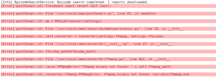

Hello @randomninjaatk,
I just setup this Docker here recently and cannot get the SMA portion to function properly. Keeps saying it cannot access/find FFMPEG. I have update the path in the autoProcess.ini file from "ffmpeg" to "/usr/bin/ffmpeg" and the issue is still present. Any other recommendations to get the script working?
@cleight
Sorry for not seeing this, all that should be needed is ffmpeg in the line for it, with no path. Are you still having an issue with this? I can look at resolving it over the weekend.
