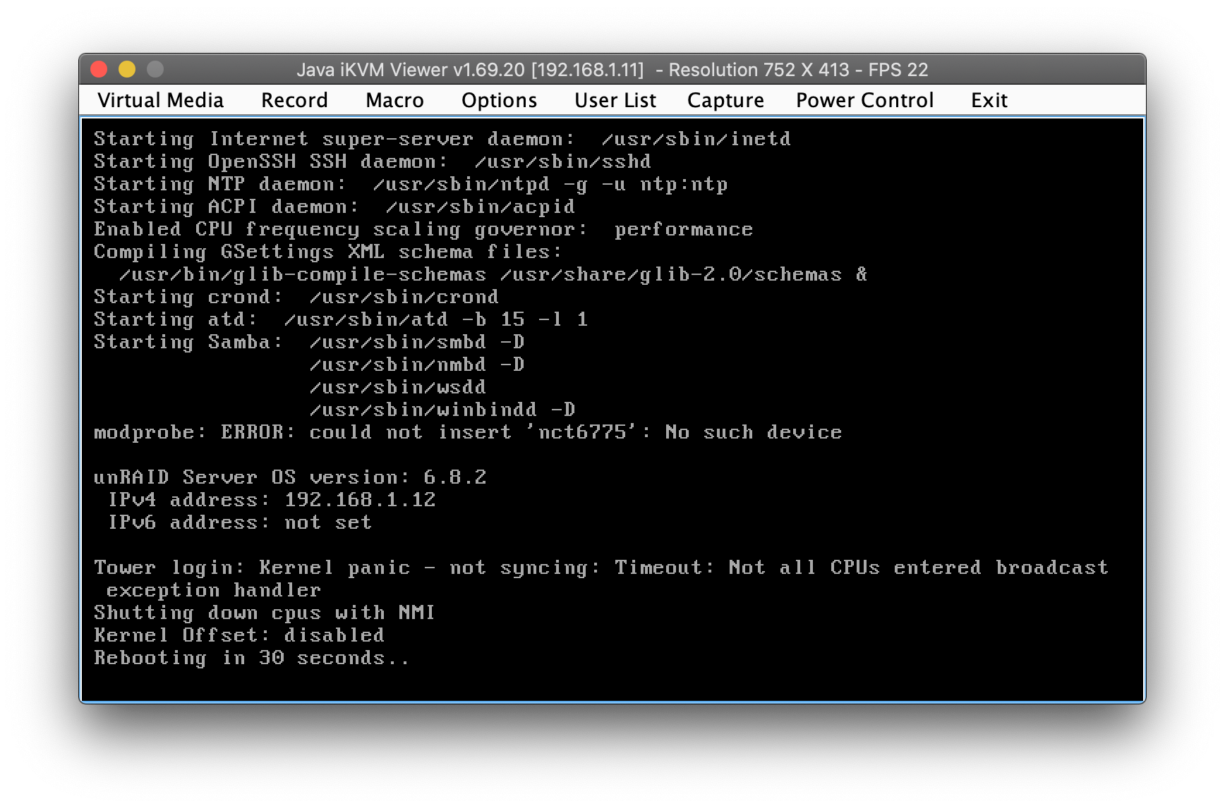

I'm trying to pass-through a GTX 670 GPU into a Windows VM for the purposes of running a nvidia gamestream host.  Unfortunately, when I try and passthrough the GPU into the VM, Unraid has a kernel panic, with following message (I should note that when using Splashtop Personal (or having the GPU connected to a monitor), the graphics card is clearly recognized, and the resolution starts adjusting accordingly).
Kernel Panic - not syncing; Timeout: Not all CPUs entered broadcast exception handler.

Using VNC without the GPU, everything works as expected.

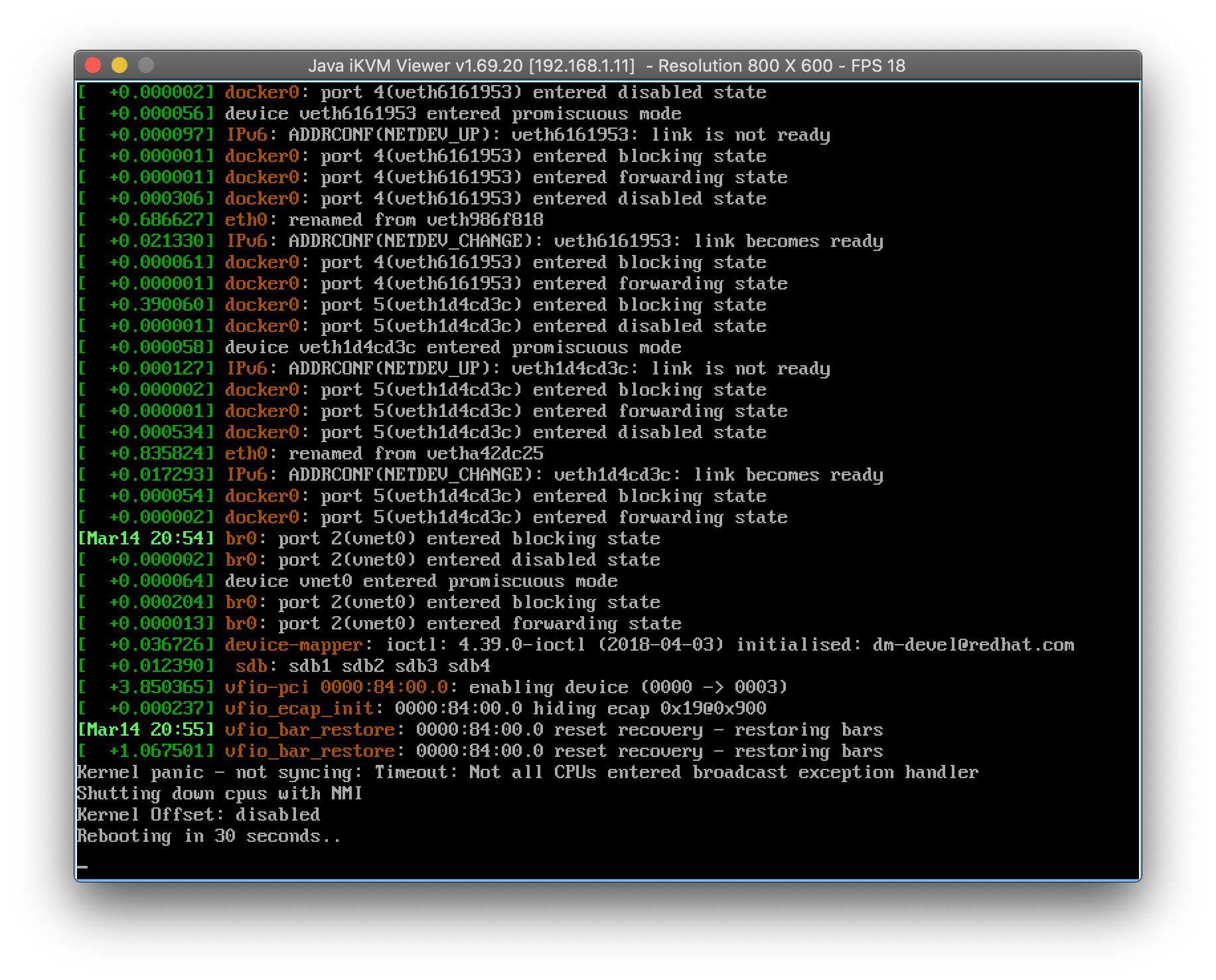

Digging through the syslog myself, these appear to be the last two entries before the kernel panic
Mar 11 17:55:20 Tower kernel: vfio_bar_restore: 0000:83:00.0 reset recovery - restoring bars
Mar 11 17:55:24 Tower kernel: vfio_bar_restore: 0000:83:00.0 reset recovery - restoring bars
The device 83:00.0 is the GPU I'm trying to pass through.

Anyway, I trie adding the following options when booting, but still with the same result.
append isolcpus=16-19,36-39 pcie_acs_override=downstream,multifunction intel_iommu=on rd.driver.pre=vfio-pci video=vesafb:off,efifb:off initrd=/bzroot
This time I had dmesg -wH running, I don't think it gave me any more meaningful information, but I'll post the screenshot regardless
598519868_ScreenShot2020-03-14at8_56_37PM.thumb.png.67b307010a31cfce3eb33da5d09792e9.png
At this point, I'm just starting to suspect that this GPU just plain won't work with passthrough.  I'd certainly welcome other things to try if anyone has other suggestions.
