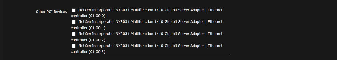

So i searched online how to get in passthrought to a VM and find the vid from @SpaceInvaderOne for pf sense. and followed his guide to passthrought my quad NIC.
i rebooted my server en it al whent good. see My IOMMU
They also apear in here.
