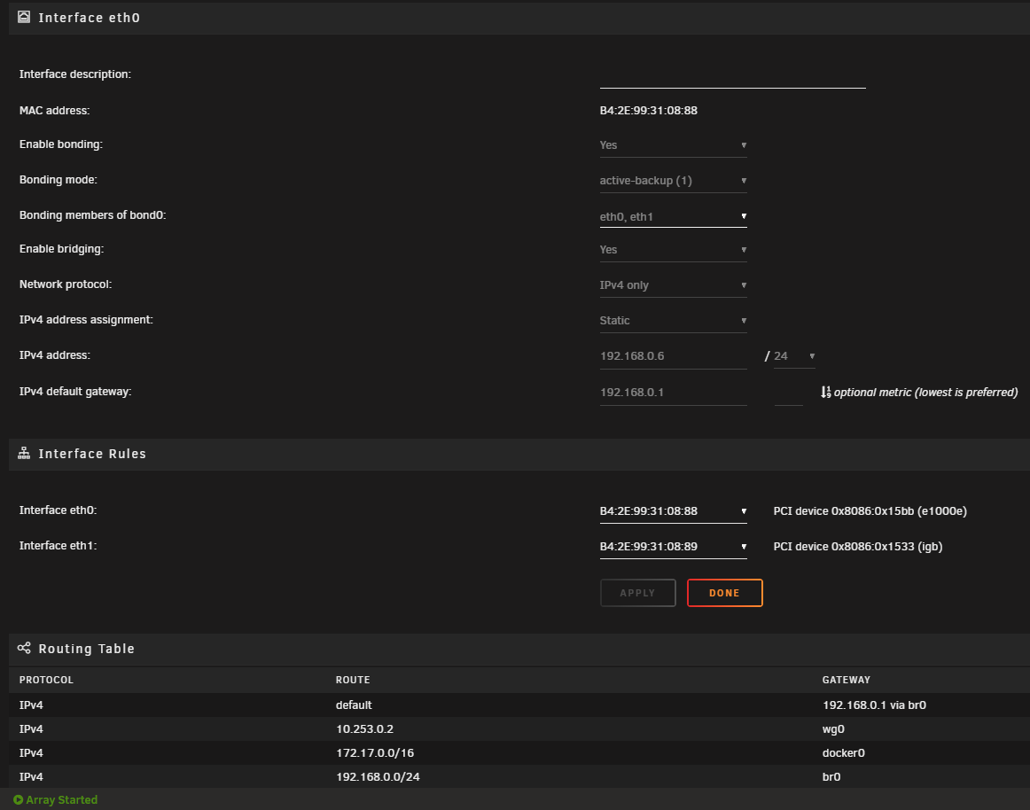

I am trying to setup to separate IP's with different ISP's/Gateways (NIC's) that I can select for my dockers?
eth0
IP: 192.168.0.6/24
Gateway ISP1: 102.168.0.1/24 (Unifi USG3 router)
eth1
IP: 192.168.0.7/24
Gateway ISP2: 192.168.0.18 (Pfsense VM running on Unraid)
But after separating them I got into a lot of trouble with my Dockers which sofar have used ISP1 and kept pointing to 192.168.0.6?
Is this possible using the Unraid UI for LAN settings?
Current IP configuration:
I tried splitting them by disabling bonding and removing eth1 and then adding static IP's to each of the NIC's with different gateways?
That really messed things up, and I had to restore my "network.cfg" on my flash drive from a backup to get things working again
Is it the routing tables I need to define?
It would also be great to have a secondary gateway definition in case the primary ISP went down? - But that is not a priority
Right now I would just like to get my new ISP setup for UNRAID dockers
Thanks
Casperse
Docker networks don't support networks with more than one gateway.
They also don't support having more than one docker network with the same subnet / gateway
What you really should have here is a router (even a linux VM) that will do src based policy routing against the two wans so ip group 1 uses ISP1 and other IPs use ISP2 but they all point to the router.

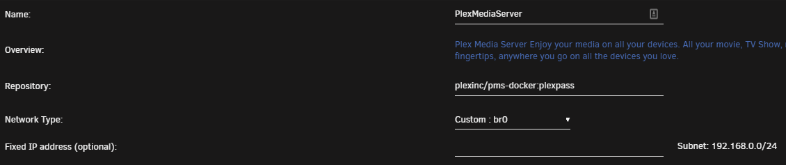

I just need to use the two NIC's on the server for two different IP's that I can select on each Docker?
I can see that in the Docker settings I have this:
But I cant get one docker to use 192.168.0.6 and another to use 192.168.0.7 (Same gateway)
Is this also not possible?
Br
Casperse
Like I said docker can't have two networks with the same subnet (ip range)
Your best bet is to alter your network such that both ISPs gateways have a different subnet ie 10.0.0.1/24 for ISP1 and 10.0.1.1/24 for ISP2, then use a multi-wan capable router or VM (don't like this option) to merge the two and do balance/failover/source routing/etc. and the pfsense VM is ok, idea but you need more network card ports on your Unraid than you have (I think)
