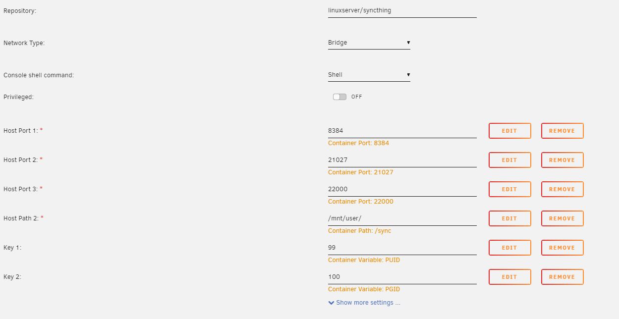

Care to share your docker setup for that?  I cannot get it to create or share folders. Keeps telling me that it has no permissions..when I can verify that it does. I am setting this up on machines with existing shares/folders.
No problem..
On 3/23/2020 at 11:38 AM, Helmonder said:
No problem..
Thanks. Yeah that is the setup that I am using for the docker.  I guess it is something to do with the actual program configuration from the WebUI.  When I try to sync a folder it tells me the folder already exists.  Any ideas?
Under Advanced Setting do I need to make changes to the Default Folder path?
I got it!! It was a problem with the docker config and an alias. I had to expand the docker config to see it!  Thanks!
Thumbs up !
Make sure you set your inotify handlers high.. Nothing will go wrong if you don't, syncthing will ask for an increase when needed.
