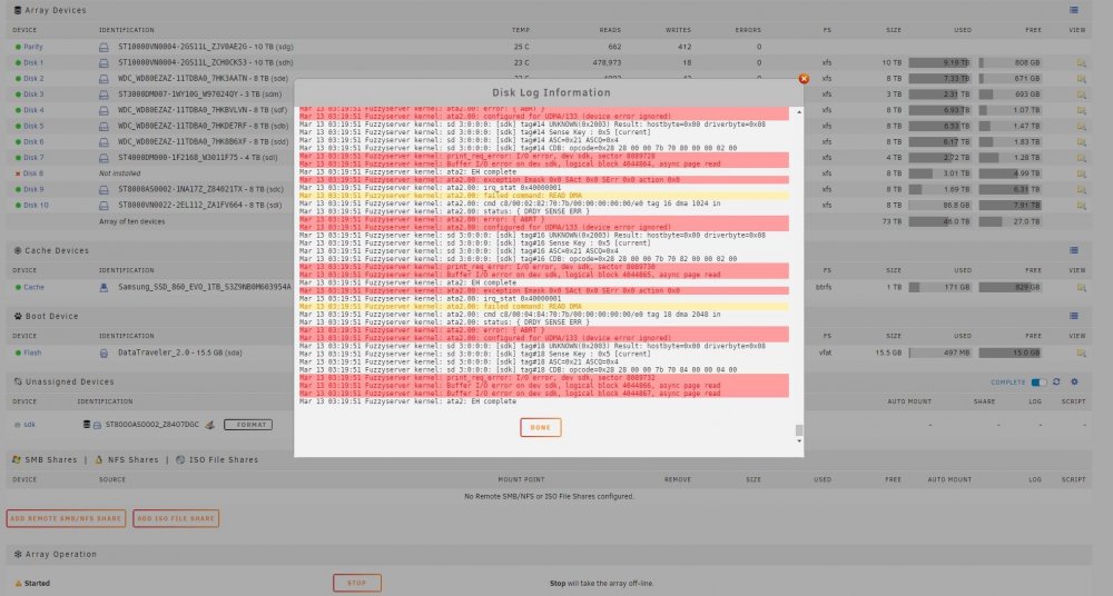

SMART failed, "Disk not installed"
Soo when i checked my Unraid i got a red warning saying disk8 had failed with SMART reading.
After restarting unraid it is shown as Not installed and the drive is emulated (the disc is now under unassigned devices.
After some googling it seems that the concesus is that its not a bad drive but a bad connection.
I have swapped out the S-ATA cable and used another s-ata port on mobo known to work earlier.
Restarted unraid again but it still says disk not installed etc... Do i need to do something special for this to work?
I have a lot of free space so if the disk is broken, can i move the emulated content over to the other disc and just remove that one and rebuild parity?
Kinda lost at best approach etc xD
fuzzyserver-diagnostics-20200313-1305.zip
