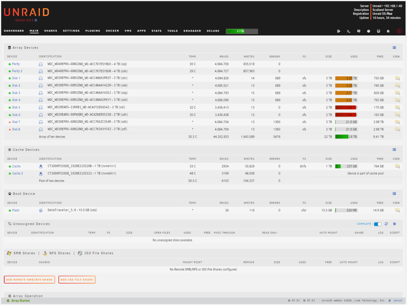

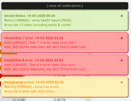

Back story:
I just upgraded my parity drives from 3tb to 4tb
Then added the 2 old parity 3 tb drives as data drive to the array.
Since then I have not been able to pass a parity check.
Greatly appreciate any suggestions
unraid-diagnostics-20200314-0940.zip

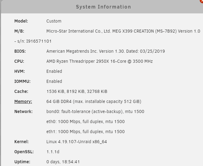

Bios looks up to date ver 1.3
newer kernel??? not sure how to check this.
Newer kernel would come with a newer Unraid release, e.g. you could try v6.9-beta1 which comes with kernel 5.5

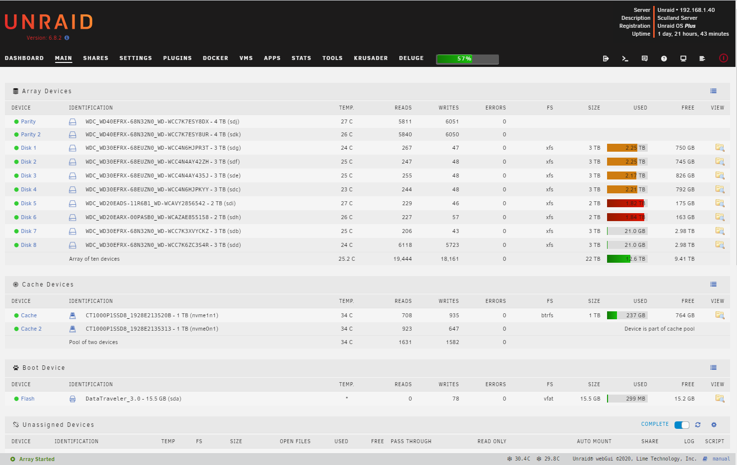

Issue Solved!!!
The issue seemed to be with the amd on board sata controller, as only the drives connector to it would have errors during the parity check which didn't happen before and I have had this system since 2018 ish.  I did try unplugging the connectors and putting new ones in. Same issue.
The parity issue only started happening after I was on UnRaid 6.8.3 so I restored the old version 6.8.2
Went to tools => new config
carefully ensured all drives where in the correct slots (serial numbers and disk slot number) and was able to add each back to the array one at a time, with ZERO erros ! :)

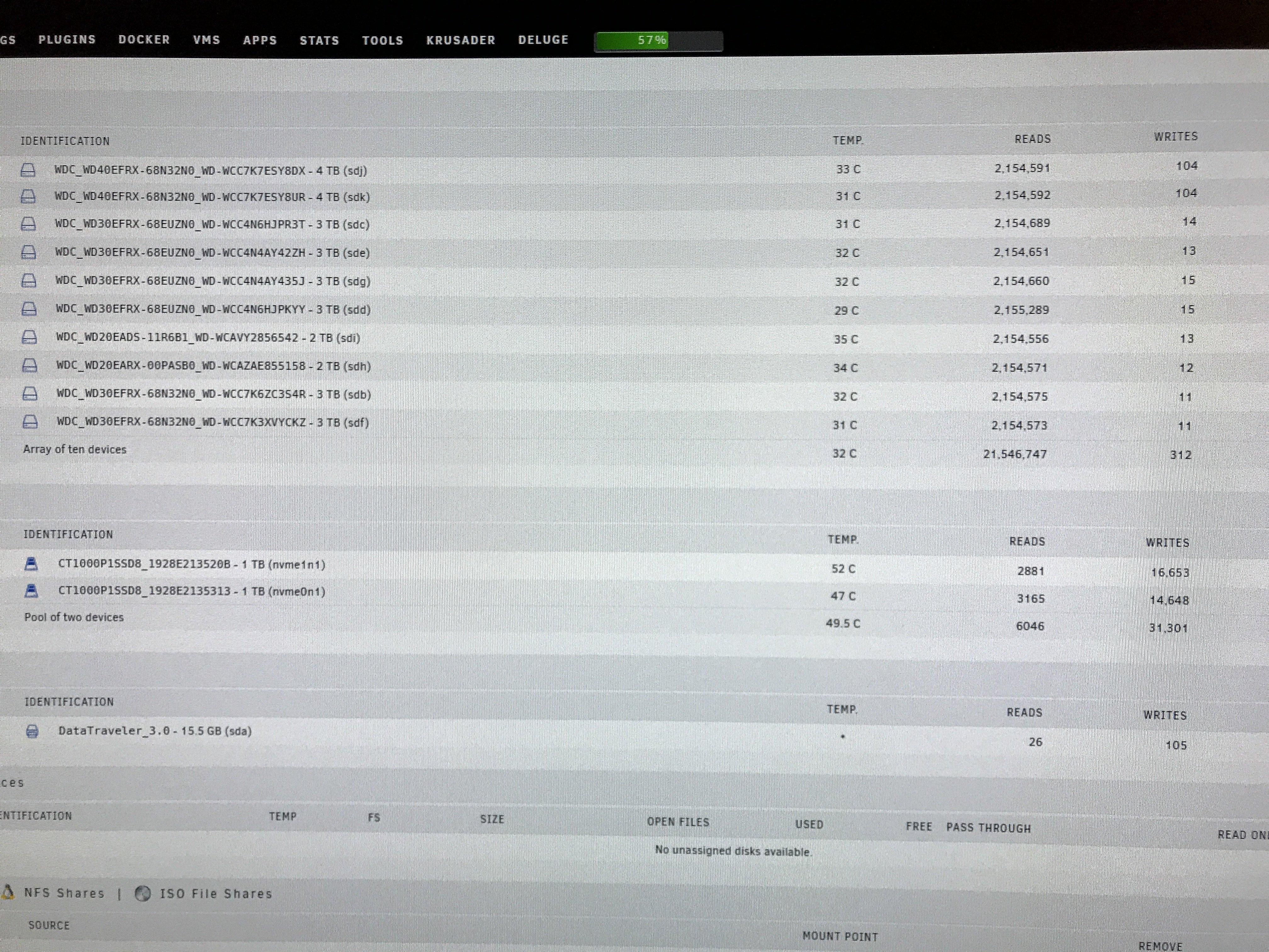

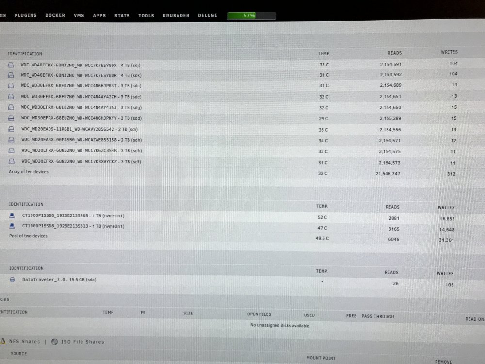

    Attached Image for things now working!!!
