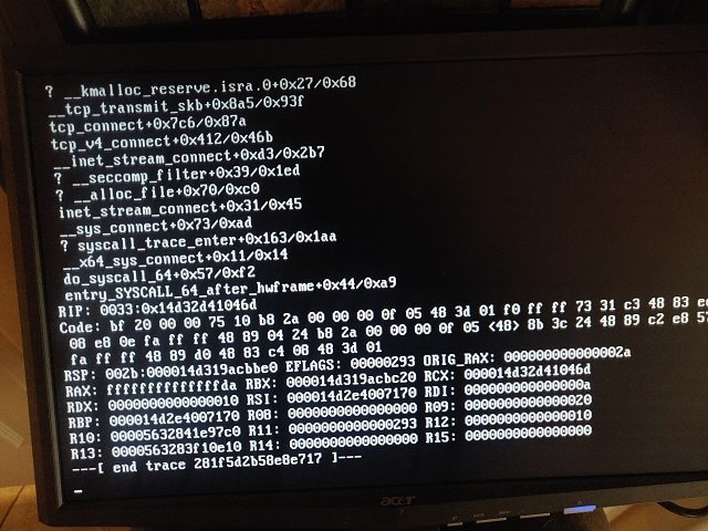

Twice in the last month my unraid server quit responding and i had to power cycle it. How can i troubleshoot the issue? Attached is the screenshot of the screen after the issue.
You should start by posting the diagnostics, there are some known issues with some hardware, e.g. Ryzen, besides that see this.

Thanks. I enabled remote sys logging. Now we wait until it happens again?
Yep, then post the syslog, it might catch something.
Looking at the log i think i captured an error and the system must have rebooted because i did not notice it was down. Please let me know if you see the issue. Maybe i need a new flash drive.

Please post the complete syslog.
Ok. My system is down now. I attached the complete syslog
messages.txt
Macvlan call traces are usually related to having dockers with custom IP addresses, more info here, in the end there was a general protection fault, possibly unrelated and might be a hardware issue, but see if getting rid of the call traces helps.
