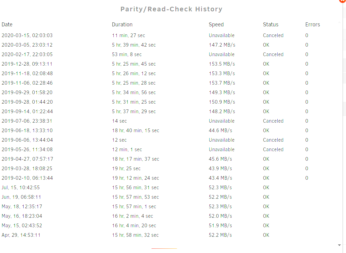

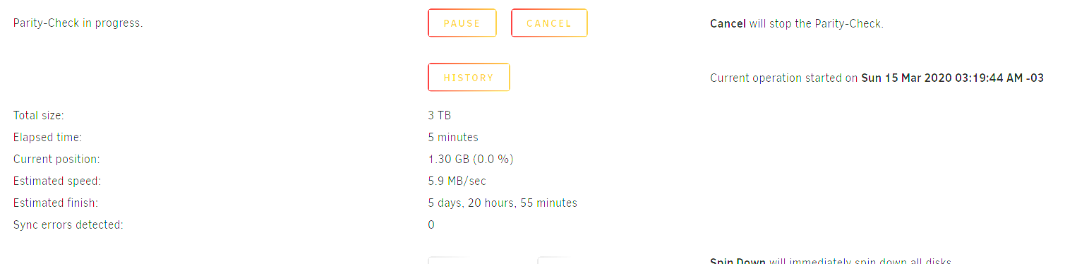

I am having a recent issue where I noticed that my server had started a parity check, but when I took a look at the values it was doing it at an extremely slow speed, saying it would take days to finish.
As per the attached screenshots, it was fine a little over a week ago with the last completed parity check.
Can anyone help me diagnose this and what I would need to provide?
I am also now scared that I may not have setup proper notifications and while s.m.a.r.t. says "healthy" for most my disks, that the counters are not good (something I'm not good at interpreting) but I will create another post for that issue.
P.S.: note that the jump from about ~50MB/s to ~150MB/s corresponds to when I upgraded my server from an old Celeron w/2GB RAM to a newer i3 9300 w/16GB system.

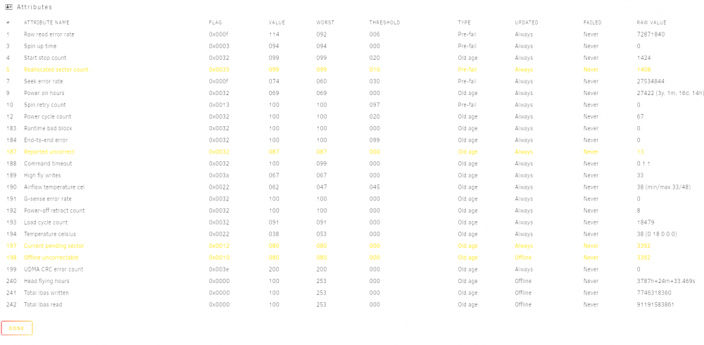

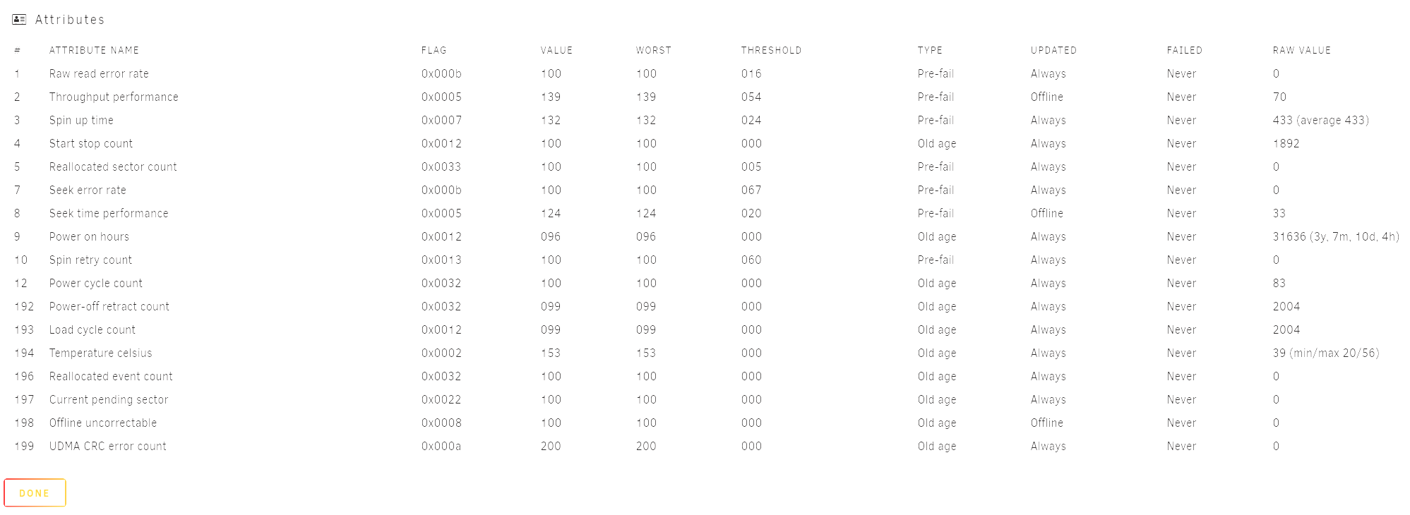

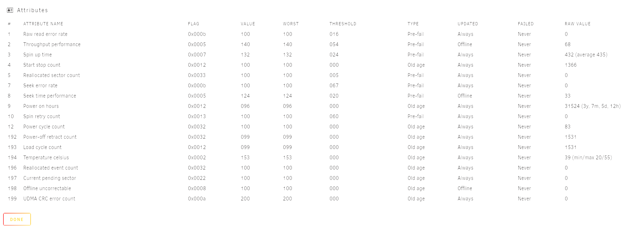

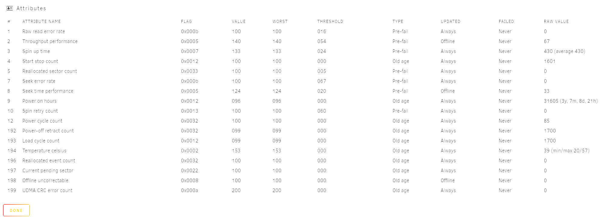

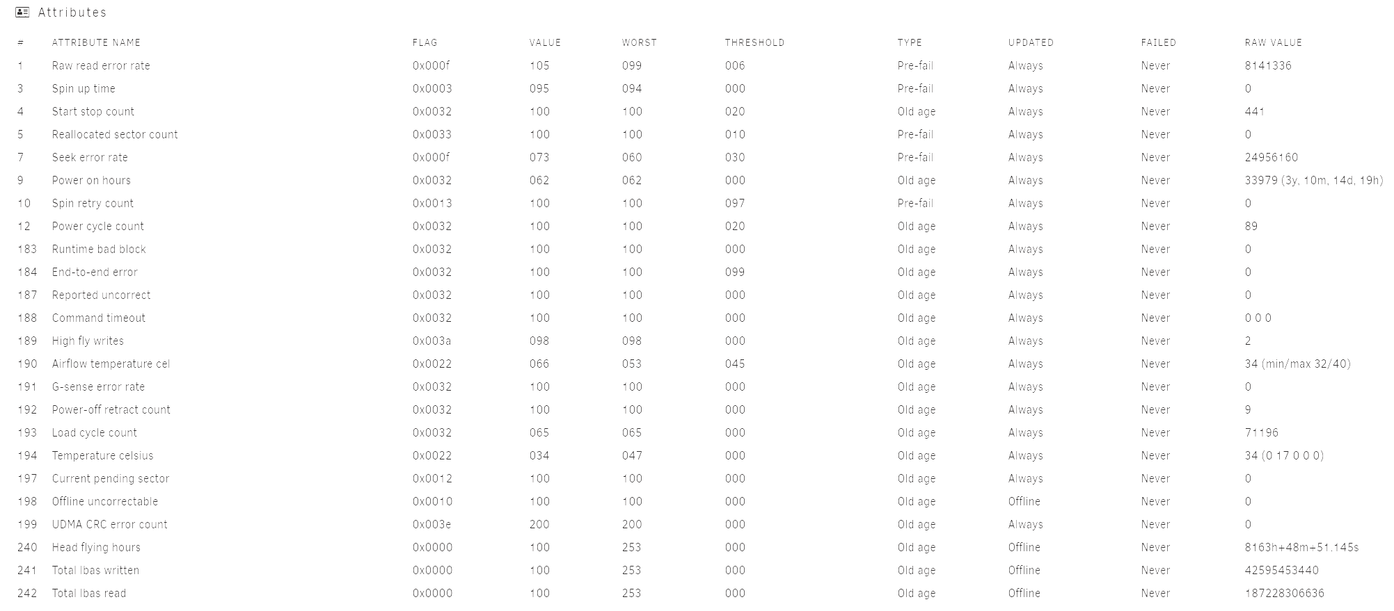

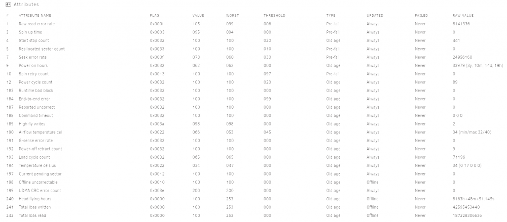

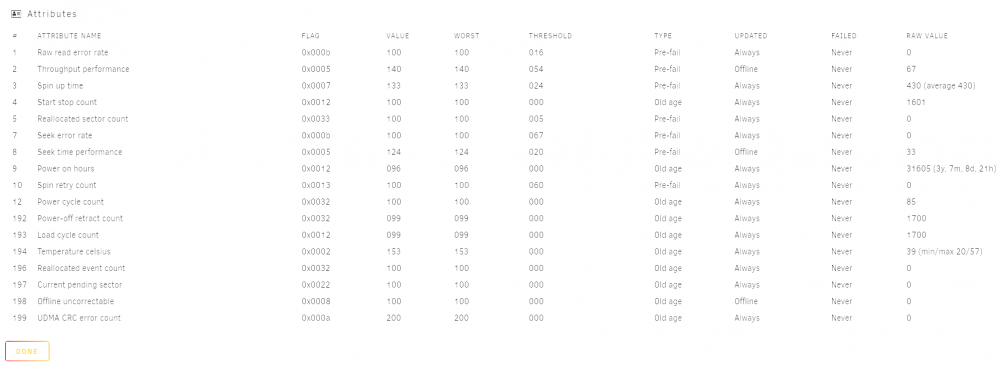

Hi All,

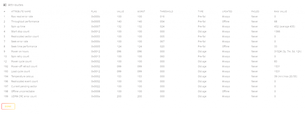

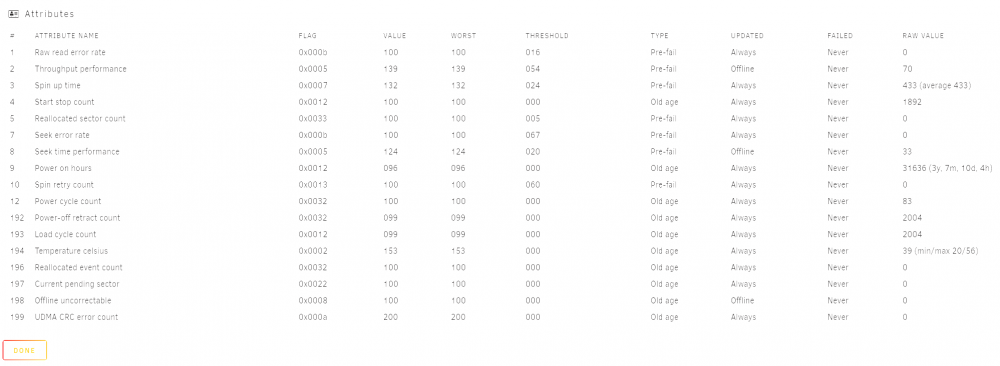

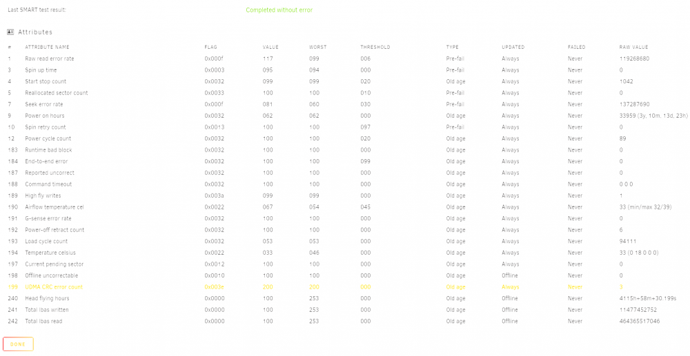

While I was looking into a slow speed in parity check I am having, I got alarmed reading something about s.m.a.r.t. counter values and what I see for the values of my disks.
Up to now, the most I had seen on the main s.m.a.r.t. screen was an occasional CRC error info, which I read would be normal and no big deal.
What I got from the threads I have seen however is that things like the "Raw read error rate" for example need to be zero, and having values here mean the disk may fail...
Now, I don't really know much about this, (is there a good explanation/tutorial anywhere?), but the attached is what it is showing for my disks. Would appreciate if any knowledgeable folks can take a look and tell me if in fact I am in dire need of replacing some of these... ☹️

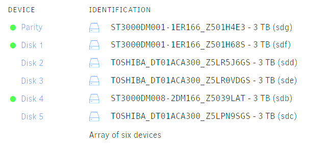

What brand of disks are these?   The way that field is used varies by manufacturer.

Seagate and Toshiba.
Edited the OP to add this info :)
Thanks.
I know that for Seagate that is a bit dependent field so cannot be easily interpreted.    Not sure about Toshiba drives.    It is Western Digital drives where the raw value is normally of concern when none-Zero.

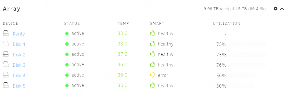

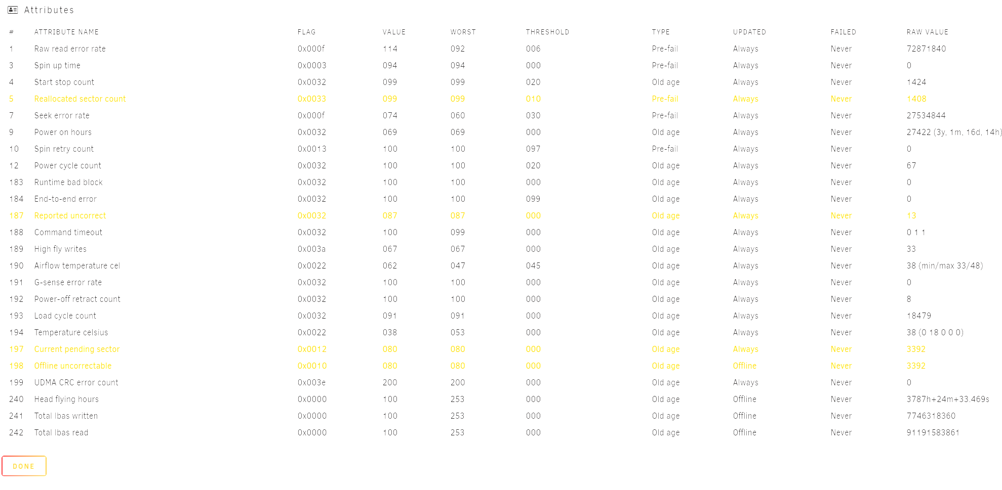

In any case,  at least from the screenshots without analyzing the values themselves it would seem to be pointing out that at minimum Disk 4 needs replacing ASAP, and I wrong?
You are correct - disk4 is looking a bit sick with that many reallocated and pending sectors.
Ok, luckily I have an extra disk on-hand I had purchased for expansion.
What is the best way to proceed in this case? Hook the new disk up to an extra port (I need to add an expansion card, which I had also purchased, to have more sata ports as the motherboard's are full), pre-clear and replace Disk 4 with this new one? Or can I just disconnect Disk 4 and connect the new one in the same slot? (and then pre-clear and add/replace)
