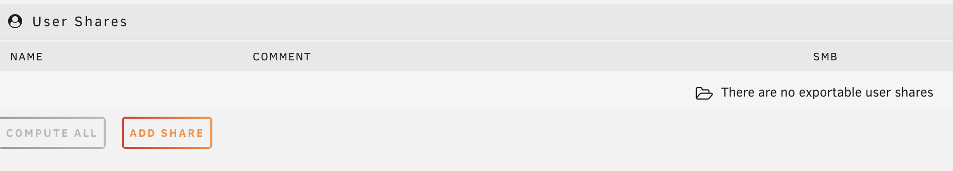

I have a user who brilliantly decided to play with the linux shares in /mnt/user/.  So, now, all user shares no longer show in the GUI, and are not accessible via SMB.  I do still see the shares in the CLI, just not the GUI.  I'm thinking permissions are screwed up, but I'm not exactly sure how.  I tried running New Permissions, but not luck.  Here's what I see:

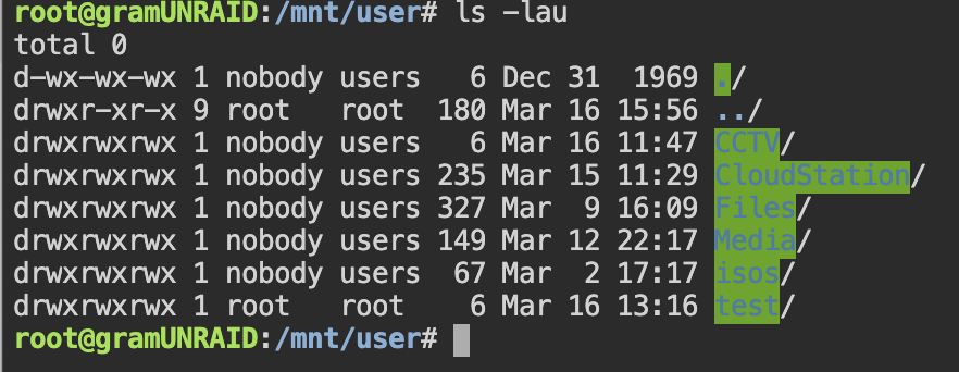

That folder named test isn't right, but I assume you created it from the root account. The others look OK as I said.
Your diagnostics thinks the shares have files on various disks.

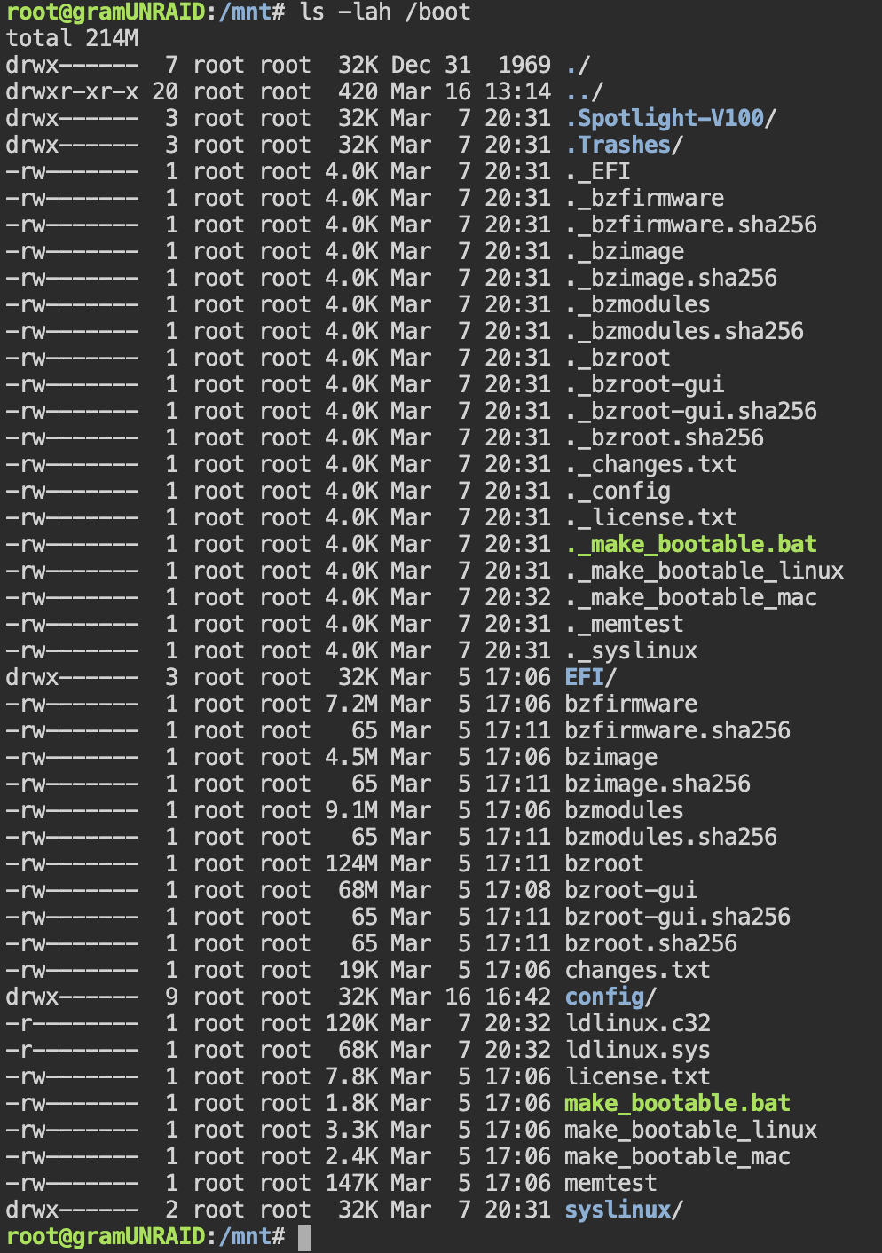

What do you get with this?
ls -lah /boot
ls -lah /boot
1584569675_ScreenShot2020-03-16at4_49_03PM.thumb.png.780d2bc33ea957b8a2c0919d23e2cc81.png
Some additional information.
I ran New Permissions once more, and it seemed to run through everything and reset all permissions correctly.  Still no love.  I then shutdown the server and moved the usb from an internal USB3 slot to an external USB2 slot, hoping that somehow USB3 was causing issues.  No love.

Your problem is right here.  The permissions are wrong for  mnt/user.  They should be:
Yatzee!!
Thanks man.  This was driving me nuts.

No, those are the correct permissions for /mnt  and /mnt/user   (i.e., ../  and ./   )  See below:
