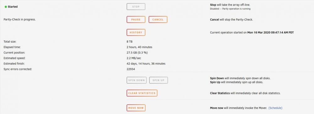

I'm also having this trouble, it started after a power outage, I do have battery backup but it's not recognized by the system so no auto shutdown occured. After it came back up I started getting massive sync errors on one of my parity drives, but that turned out to be the sata cable (I have ordered a full replacement for all drives). After I put in the new cable I started getting around 50mbs per second which was great, but after about 10 min's it's barely 1 mb per second. Not sure what's going on now.  Any ideas would be great, see snapshot and diags..
Thanks in advance..

You are having problems communicating with multiple disks. Check all connections, power and SATA, both ends, including power splitters.
You are currently getting continual resets on your parity drive which is why it is running slowly.   That is typically a cabling problem, but it could also be power related, or even a problem with the drive itself.
It is probably worth running an extended SMART test on that drive to check its health.
