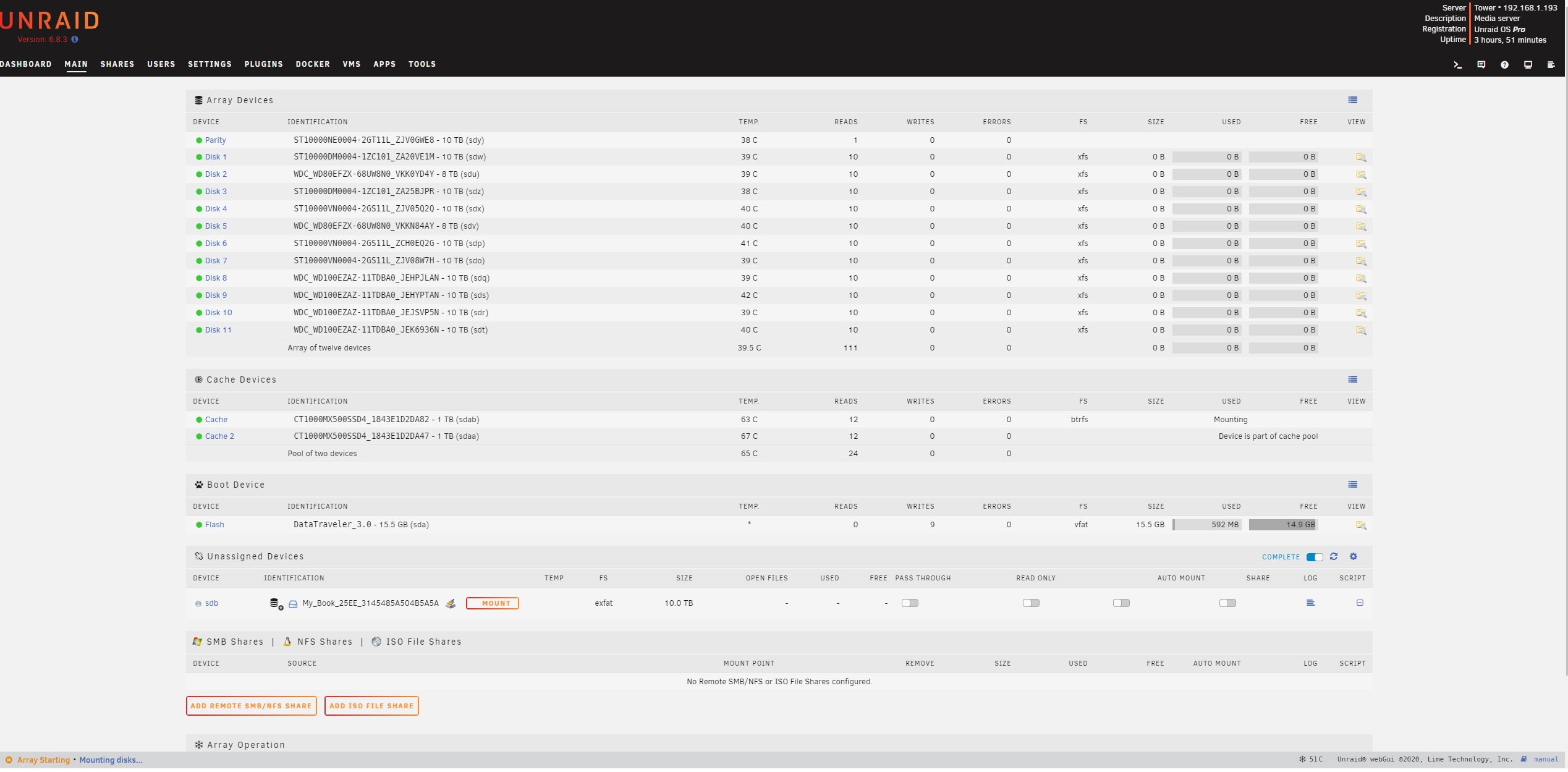

Since ive had my server, it takes >90 mins to start my Array, I had hoped with the OS upgrade this would be fixed but its still taking over 2 hours to start the array.
The server always has an internet connection on start, but I'm not sure what is causing this.
During the starting process, this is what I see on my main page

Is is the same if you boot in safe mode?
HI
Yes its still the same, same "main" page as above
Pleas post new diags after booting in safe mode (while or after the array starts).
Looks like controller issues.

Agree, but I would like to see the syslog since boot, it's missing a lot.
It's still only the same error repeated many times, reboot, wait a couple of minutes and grab new diags.
Did you do what I asked? Those diags still have an incomplete syslog.
There are errors from the LSI HBA right from the beginning, you'll need to try a different HBA.
