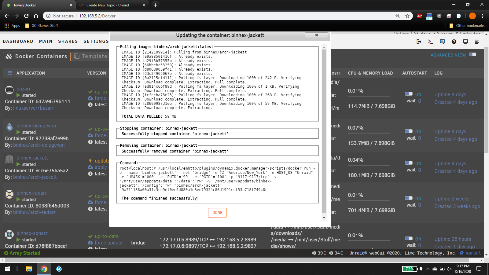

I constantly have problems with docker updates.   MariaDB is the biggest one, each time there is an update, i have to remove the container and re-add it back in order for it to update properly, otherwise it never updates, it looks like it will update, but just goes back to the same container.  Anyone else have this problem?   It occurs on multiple dockers, mariadb, binhex-jackett, binhex-delugevpn, and others.
I keep seeing this error in the diagnostics "level=error msg="Not continuing with pull after error: context canceled""
I've recreated the docker.img twice thus far and still see this type of problem whenever there are new updates.
Anyone have any clues?

So i went ahead and expanded my docker image size to 20gb...  and once again, it still doesn't update.  the only docker that does not give me problems is duckdns...  it updates just fine, all others, binhex-jackett, mariadb, bazarr... none update properly, they look like they are updating, but never properly update.  Annoyed to have to delete the docker every time to update it..   could having my docker.img on an unassigned ssd cause the problem?
