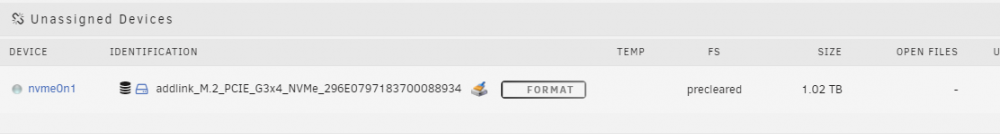

This is a screenshot of my unassigned drive.Untitled.thumb.png.433fde6ff0e28cd4669942cc2c711f73.png
Do I need to do anything?  Mount it or anything?

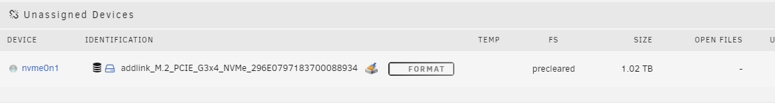

Your SSD is not even formatted so definitely wasn't mounted. So your /mnt/disks/Windows was in RAM.
You need to first format the UD (you might need to install Unassigned Devices Plus plugin to be able to enable destructive mode in the UD settings to allow formatting - otherwise, the Format button is greyed out). Pick either xfs or btrfs depending on your needs.
Then change the mount name to Windows and mount the formatted UD. Only then it will show up in /mnt/disks/Windows.
