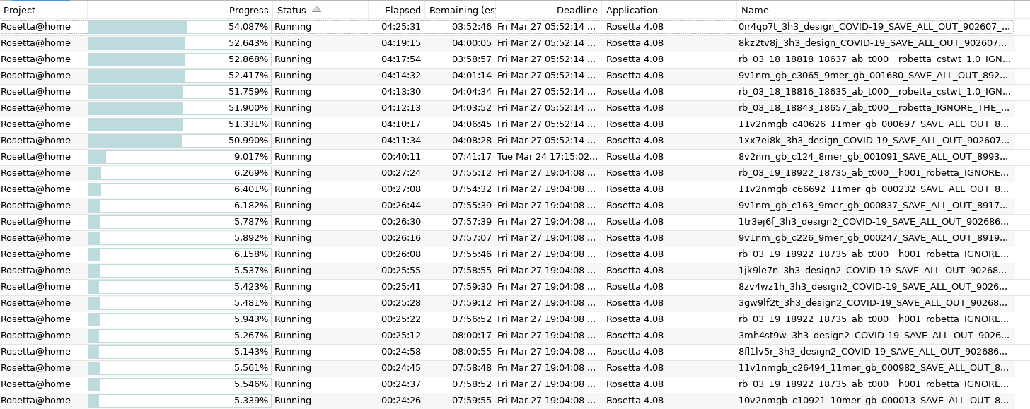

I got it working, but I am noticing that in the jobs it downloads, the ones where the "Application" field is "Rosetta Mini 3.78" throw a Computation error.  the ones marked Rosetta 4.08 seem to be processing fine.
I have couple of Mini 3.78 tasks running (the others are 4.08).  They are about 28% done and I have yet to see a computation error.  They have been processing for 2 hr 15 min.
Does it happen for you when the task starts or does it run for awhile before you see the error?
it seems right when it starts.  it downloads and them immediately throws the error
I'll let it run for a day or two, see if it was just those particular ones and if any future ones throw errors.
Edited by mattekure
According to Squid, the rb_{date_ID} tasks (Mini 4.08) are where you find the COVID-19 tasks as they are submitted under robetta.  The others are not COVID-19 but may be related.  There is no way to really tell.
When I started with this container yesterday. I immediately suspended anything that was not rb_ until it picked up more rb_ tasks.  After those completed this morning, I tried the same but I kept getting a bunch of DS_ tasks so I let it ride with 5 rb_ (Rosetta 4.08) and three DS_ (Rosetta Mini 3.78 tasks).  The latter have been chugging along fine for me.
I'm not so sure.  I see a bunch of tasks with covid in the name, not starting with rb_.
