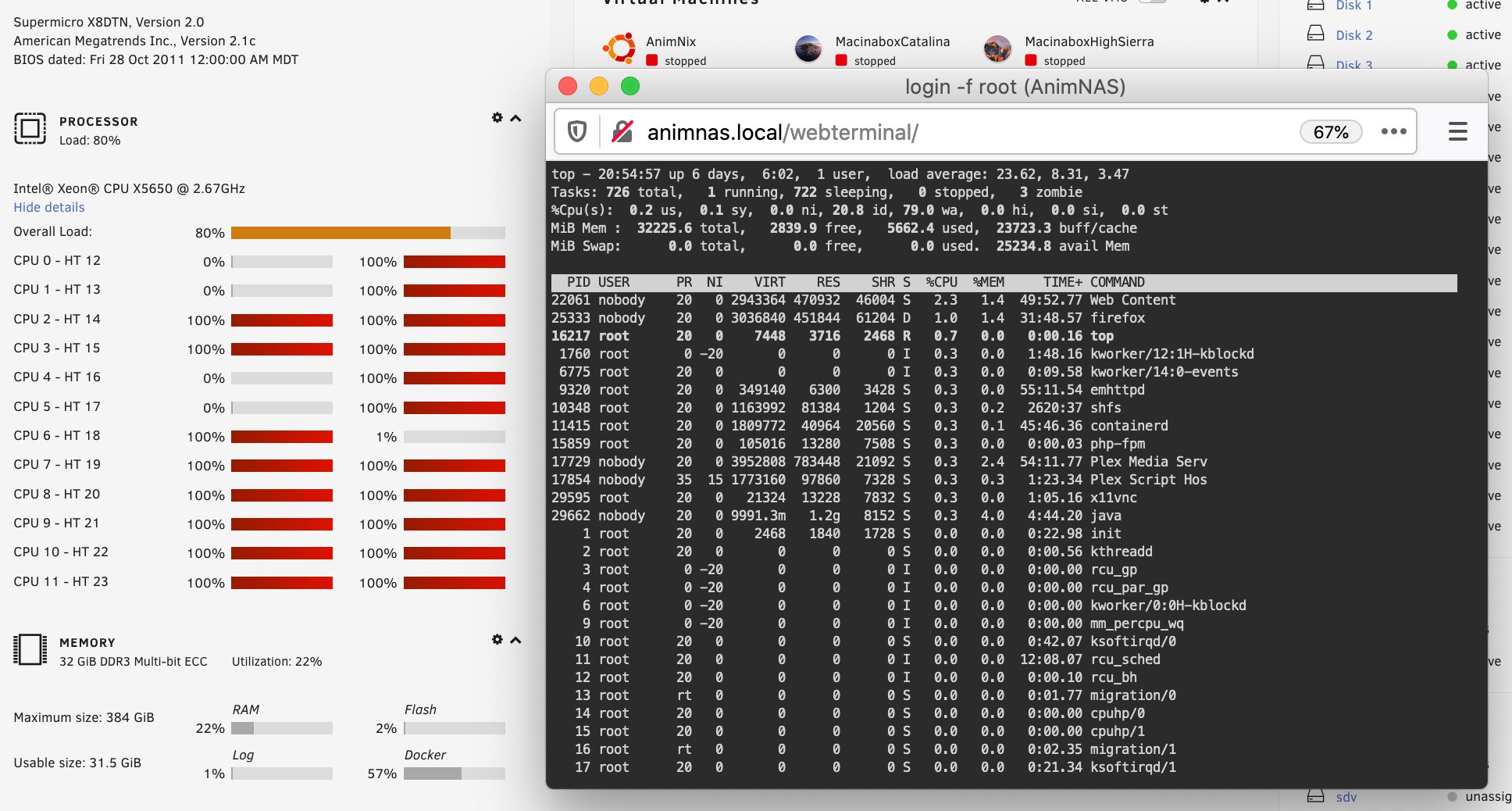

@KLAK Just curious to know how you've progressed with this issue? I'm also experiencing random 'temporary' freezes on my media unRAID system. They last anywhere from 5 - 45 seconds during which the unRAID webgui becomes largely un-responsive and Docker containers like Plex freeze. It usually results in any content being played to stop until the system resumes normal operation.
I'm using a Supermicro X8DTN+ motherboard (came with the CSE-847 36 bay enclosure) with dual x5650 Xeons and 32GB of RAM. The system originally had 16GB of RAM but about 2 weeks ago I started getting 'Machine Check Events' (MCE) reported by the Fix Common Problems plugin. As the 16GB was 2 mis-matched DIMMs (different manufacturers) I replaced it with 32GB that's all from the same batch and manufacturer.
I haven't seen a MCE since replacing the RAM but I am still seeing random freezes in unRAID. When this happens the dashboard shows many of the cores (physical and hyper-threaded) maxed at 100% as shown on the picture below. I try to keep an instance of TOP running to try and determine what leads to these lock-ups, but as you can see from the image, nothing appears to be utilizing all those CPU resources.
I've gone through my system log and at the time of the freezes there are no indications of any issues. I've done a reboot and am monitoring the system log for errors, but so far I have no indication of what's causing these random freezes. I am also running 6.8.3 and the only things that have changed on my system are the plugin and Docker updates for CA, UD, etc.
Note that I saw similar random freezes when running unRAID on a i7-6700K system (4 core, 8 thread) but I assumed that was due to the lack of cores/threads in the CPU. Now that I have 12 cores/24 threads, I wasn't expecting to see these lockups. The most annoying part is that neither TOP nor the syslog give me any clues as to the cause. Hopefully you've made some progress diagnosing the issue and can share your solution if you have one.

Thanks for the reply. I no longer use a GPU in my unRAID setup (other than the onboard graphics from the Supermicro x8DTN+) so that's likely not my cause. As I've replaced the RAM and my 'machine check events' went away, I'm now down to it being a problem with the CPUs, the motherboard/chipset or the LSI2008 HBA.
I just had another lockup about 20 minutes ago and it lasted for about 2 minutes. Still reviewing the syslog but so far nothing is obvious. And my background TOP window also showed no specific process(es) that were loading down the CPU cores/threads. It's definitely puzzling. I'm planning/budgeting to replace the Supermicro x8DTN+ with a new Threadripper based system eventually.
