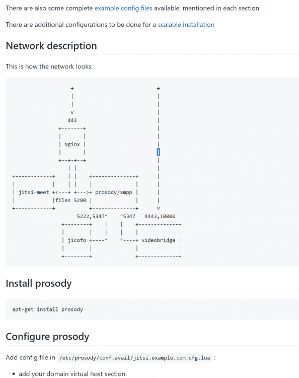

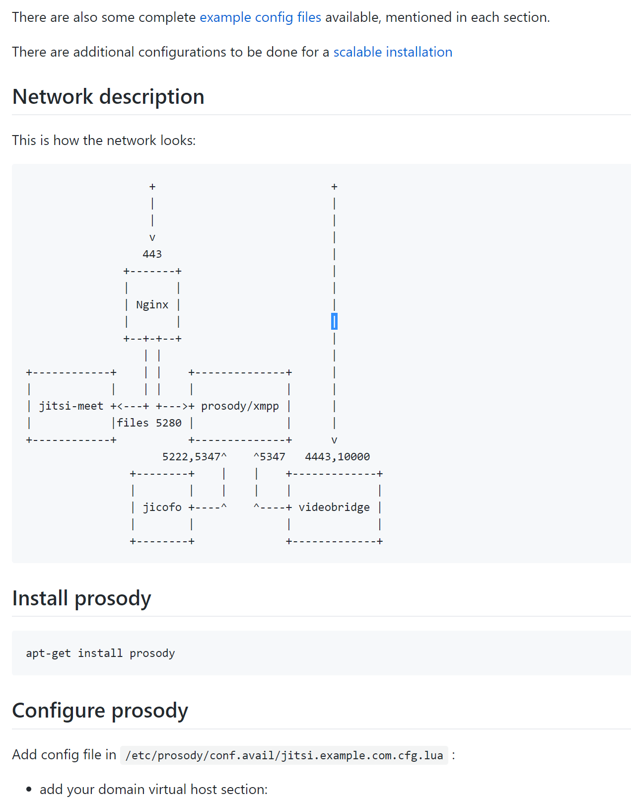

Michael Woodson Posted April 23, 2020 Share Posted April 23, 2020 (edited) Hi @SpaceInvaderOne, Correct me if I wrong, but does video bridge need port 4443 forwarded to it? https://github.com/jitsi/jitsi-meet/blob/master/doc/manual-install.md Thank you again for all you do! Edit: things seem to improve dramatically with multi-users and when switching from wifi to cellular once 4443 is forwarded to the server. Edited April 23, 2020 by Michael Woodson Quote Link to comment
dallus Posted April 23, 2020 Share Posted April 23, 2020 41 minutes ago, Michael Woodson said: Hi @SpaceInvaderOne, Correct me if I wrong, but does video bridge need port 4443 forwarded to it? https://github.com/jitsi/jitsi-meet/blob/master/doc/manual-install.md Thank you again for all you do! Edit: things seem to improve dramatically with multi-users and when switching from wifi to cellular once 4443 is forwarded to the server. I had both 10000 and 4443 forwarded and your post got me thinking. I tried not forwarding ports and found that if I forwarded 10000 but not 4443, the video worked. When I forwarded 4443 but not 10000, the video did not work. I could connect, but the video wouldn't work. Quote Link to comment

enigma27 Posted April 27, 2020 Share Posted April 27, 2020 (edited) ok so just tested forwarding port 4443 and that indeed does need to be forwarded to be able to allow access for external clients. is there a way you would not have to forward this port? it was not in spaceinvaders video unless I missed that part. p.s any guide on how to update the containers? Edited April 27, 2020 by enigma27 Quote Link to comment
Beaupnm Posted April 28, 2020 Share Posted April 28, 2020 I just tested port forwarding/adding firewall rule for 4443 and it worked for me too. Previous to that I could get users in the chat but video didn't work for anyone. Quote Link to comment
