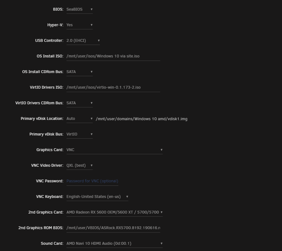

I have been trying to start my unraid server since last Friday. But I am not able to start my windows 10 VM with GPU pass-through. I followed all of SpaceInvaderOne tutorials but I cant get it to work.
VM settings:
I also ran it on the other BIOS that also didn't work.

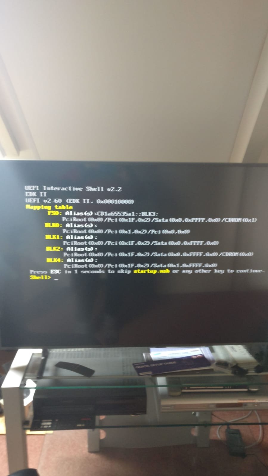

  • I also tried just running only a GPU and no VNC, and I get stuck on this screen
453617739_WhatsAppImage2020-03-19at12_12_47.thumb.jpeg.c41281efe888cb2505236f6a9dff3a44.jpeg

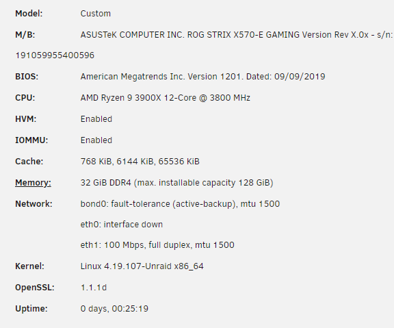

System info:
I have turn the PCIe ACS override to "both"
It is in different IOMMU groups:

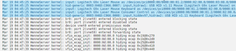

Part of the Log when starting vm:

Many issues.
  • Is the AMD 5700 GPU the only GPU in your system? If so, your chance of passing it through to a VM is rather low due to the known reset issues that happen to all AMD Navi GPU.
    • You should try compiling your own kernel with the Navi patch which may improve your chance of passing through the device. There's a forum member who shared a custom kernel with (among other changes) the Navi reset patch and optionally 5.5.8 kernal (better compatibility with 3900X) so you may try that at your own risk. Link at end of post.
    • Your vbios, how did you get it? Are you 1000% sure it's the right vbios for your card? Vbios has to be specific to the same brand, model and revision so it's not that hard to get the wrong vbios if downloading from TechpowerUp.
    • Have you updated your motherboard BIOS?
    • Try booting Unraid in legacy mode.
    • Are you able to borrow another GPU to boot Unraid with? Even with all the tweaks above, you may still need a GPU for Unraid to boot with (so the 5700 isn't initiated at boot.
  • You can't just switch bios from SeaBIOS to OVMF. The screen you showed is UEFI (i.e. OVMF) unable to boot, which isn't unusual if you installed Windows under SeaBIOS.
  • Having both VNC and passed-through GPU rarely ever works. Once you have installed Windows using VNC, turn on Remote Desktop Protocol from Windows and use RDP to connect to your VM to deal with display issues (instead of having both VNC and passed-through GPU). Of course, that is assuming your VM boots (see above point) so you need to get that sorted first.

The best thing for you to do now with the BIOS thing is to start from scratch. Pick Q35 machine type and OVMF BIOS and install Windows (from scratch) with VNC display. Then turn on RDP in the Windows VM and test with another Windows machine to make sure RDP work i.e. you can remote into the VM using RDP (NOT VNC!!!). Then go work on the 5700 pass-through.

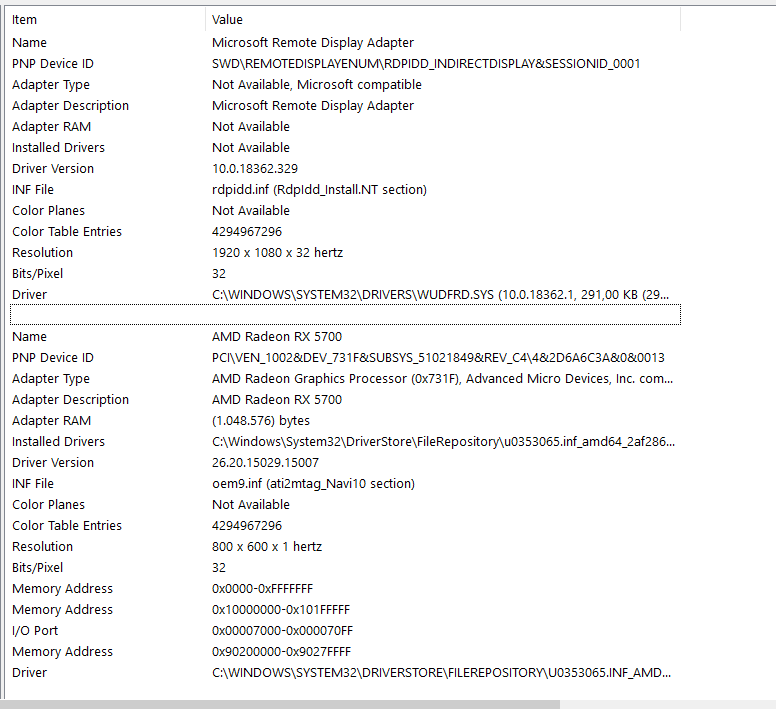

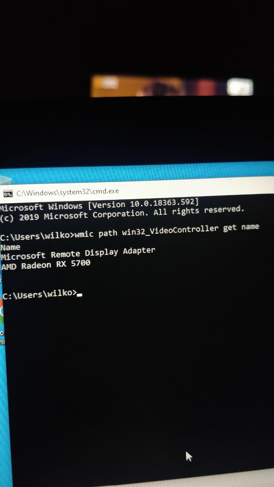

On this moment I can't go further then these steps, but it seems like it did work? After the VNC worked and immediately the RMD worked, I made a shot at it to start it with only the GPU and sound-card (of the GPU). I was able to RMD in the VM again, does this mean when I am with my server again the screen will work? Or at least that it looks promising?
I attached some photo's where you can see windows does see my  RX 5700.

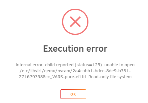

Okay, I had a screen everything seemed fine. But then 2 hours later I tried to start it again but I have a whole new error.
edit: And why I try to add a new vm it can not create the file vdisk.img
