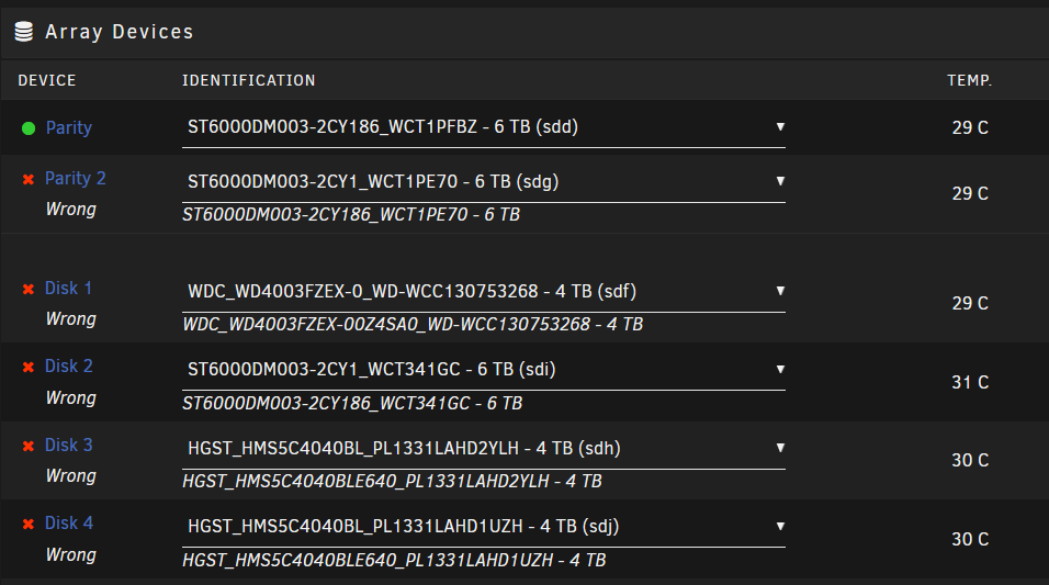

Hi all,
I just got a new LSI SAS controller for my Unraid server, but when I plug my drives into it instead of the old controller they are recognised, but recognised as different drives with the same names. It insists that the right drives are the wrong drives. Is there a way to force Unraid to assume this is valid and boot up anyway?
Thanks!
Please post diags, LSI might need a firmware update.
<diag deleted>
Would an LSI firmware update be something I could do from unraid? I don't have another machine up and running with a spare PCIe slot
Edited by Erasmus
Yep, updating the BIOS firmware should fix it.
Should be possible, boot with a DOS flash drive.
Couldn't get it working on DOS, but found an old Win10 machine with a spare PCIe slot. One firmware and BIOS flash later it's all working perfectly. Thank you!
Good, just noticed I wrote BIOS instead of firmware, firmware was the problem.
