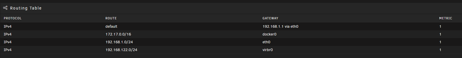

I can't connect my Windows VM to anything on my local network O_o
This Windows VM have the IP 192.168.1.41
UnRAID is 192.168.1.40 and my Internet box, for example, is 192.168.1.1
I just can't connect to UnRAID or my box :/
But i can connect to UnRAID using the "https://tower.local"
I'm on virbr0 adapter for this Windows VM and my routing table is this :
Do anyone have an idea of what it lacks, please ? :)
Do not hesitate if you need more information ^^
Thank you in advance !

Find it, that's a VPN problem, when i disconnect it the local network is reachable again
I will search how to correct that :)

Finally, it was both a VPN & a bridging problem
I activated bonding, build a bond0 interface but seems like it need the bridging to be activated to (thanks again bonienl !)
So, now all good, solved :)
