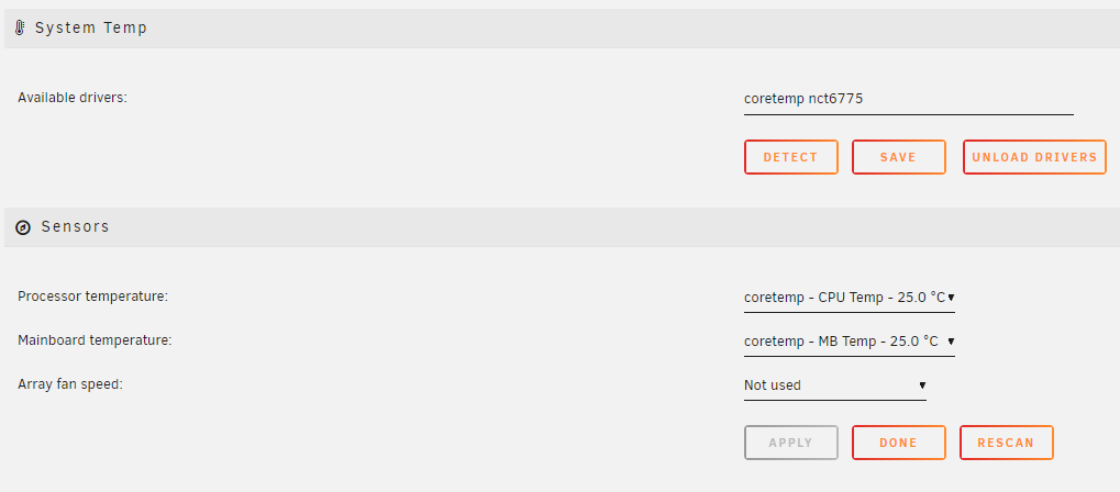

You were right in your original assessment.   When I go to plugins I have Dynamix System Temperature installed. Version  2019.11.03
image.thumb.png.1cce0c113fa121513be8db2f725bcecb.pngimageproxy.php?img=&key=e5eec7c5c933ca16
My settings are above.  If this is the wrong place to ask what's wrong I can pose a question in the dynamix or netdata support threads.  I don't know why there is no sensor section in netdata.

Works for me.  It is however way at the bottom on the right.
