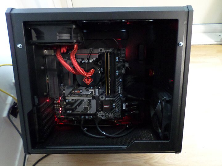

So I'm looking for some advice around a new build/upgrade, at the minute I'm running a basic unraid server with the following spec
MSI Z270M Motar
Intel Pentium G4600
32GB Ram
Corsair RM450
Samsung 970 500GB m.2 Holds my app data
3x 12TB Ironwolf
1x 4TB Ironwolf

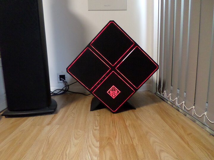

Case Omen X 900
79974_1000.jpg.aa199769d01737f5842561a9bf4a3a57.jpg79975_1000.jpg.4449ff4dee8d1019b4e06de6916f9e7a.jpg79976_1000.jpg.8100907de4a4daba69df6b53db612b96.jpg

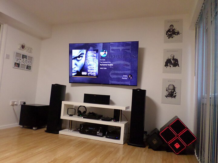

Now the first problem is I am running out of space and due to the case I really don't have many/any upgrade options once I switch out the 4TB drive for a 12TB drive. The second problem is I'm not running any parity drives due to the constraints of the case. The third problem is placement due to where the unraid server is place it has to be athletically pleasing and pass with the Mrs.
