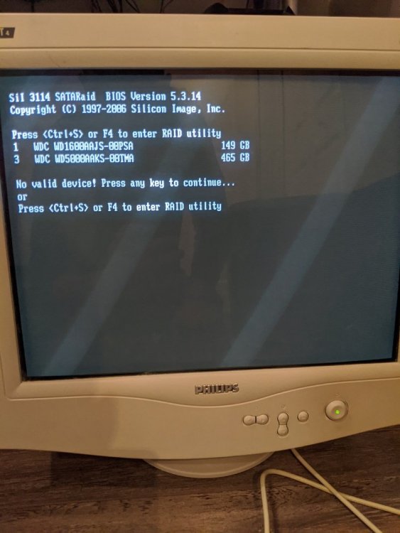

Hi guys, today I executed the update from 6.7.2 to 6.8.2. Installed perfectly, it asked to reboot, I did and now I'm stuck passed the boot splash screen at "Loading operating system...". No other modification was made.

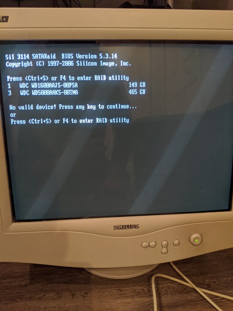

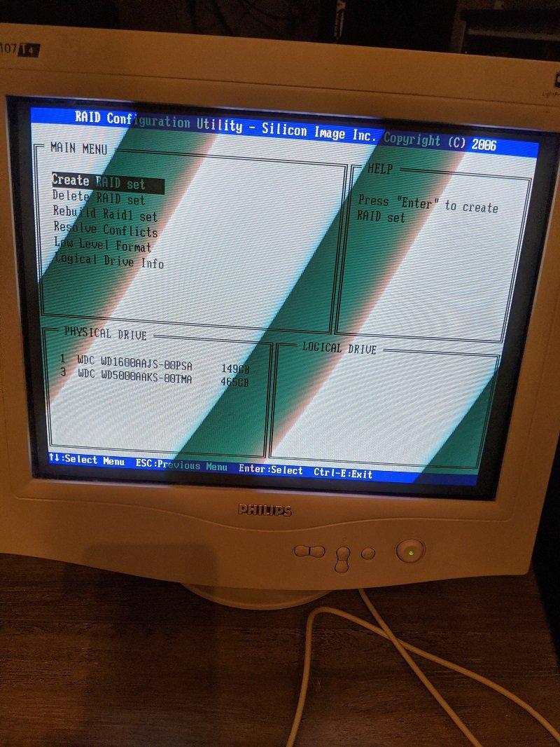

I have already confirmed the USB key is still the first boot device. I have a total of 8 drives which worked perfectly under 6.7.2. I noticed that right after the splash screen I'm getting a RAID message about no valid devices, see screenshots. In the RAID utility I have 2 drives listed, not sure I should be having a RAID setup at all.
Thanks in advance.
Looks like you're stuck at your add-on card ROM.
correct, no raid.  That card should be able to present your disks as a JBOD and unraid handles the rest.
Are you pressing any key combinations to enter the card's ROM?  Can you just ignore the "No Device" warning and continue the POST/Boot process?
Edited by civic95man
I do have an addon card to handle all these drives but there's been no change in the setup since 2 months ago, replaced drive. I am pressing any key combination and same result. I don't see any way to ignore it. What about within the RAID utility, if I delete the RAID?
Actually even if I disconnect both connected drives to the addon card, it goes directly to the Loading Operation System... screen and it stays stuck there.
Seems to work now after removing the USB key and reinserting.
