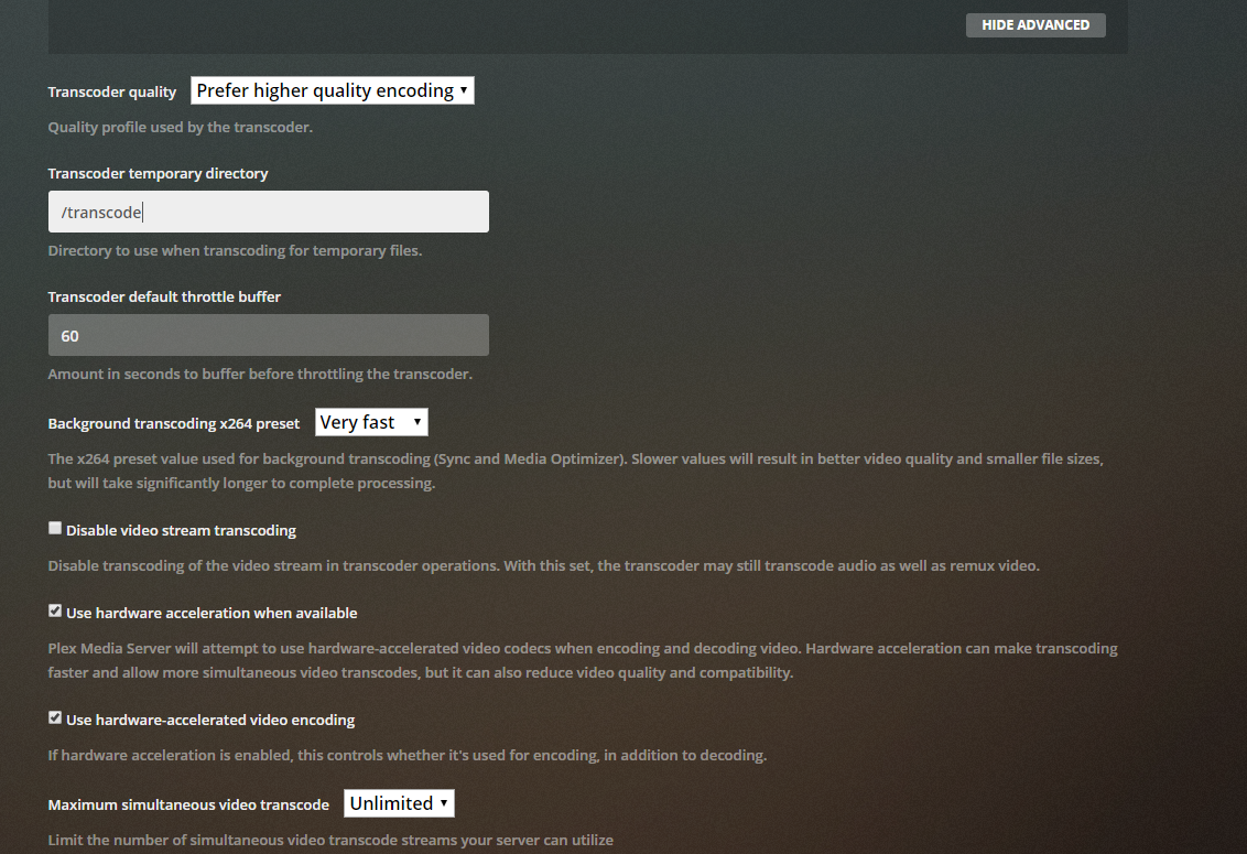

Do you have Plex transcode in RAM?
I can't see much in the syslog other than a VM (qemu process) was killed because of out of memory. But usually it's not the VM that is at fault, one of the docker probably is the cause.

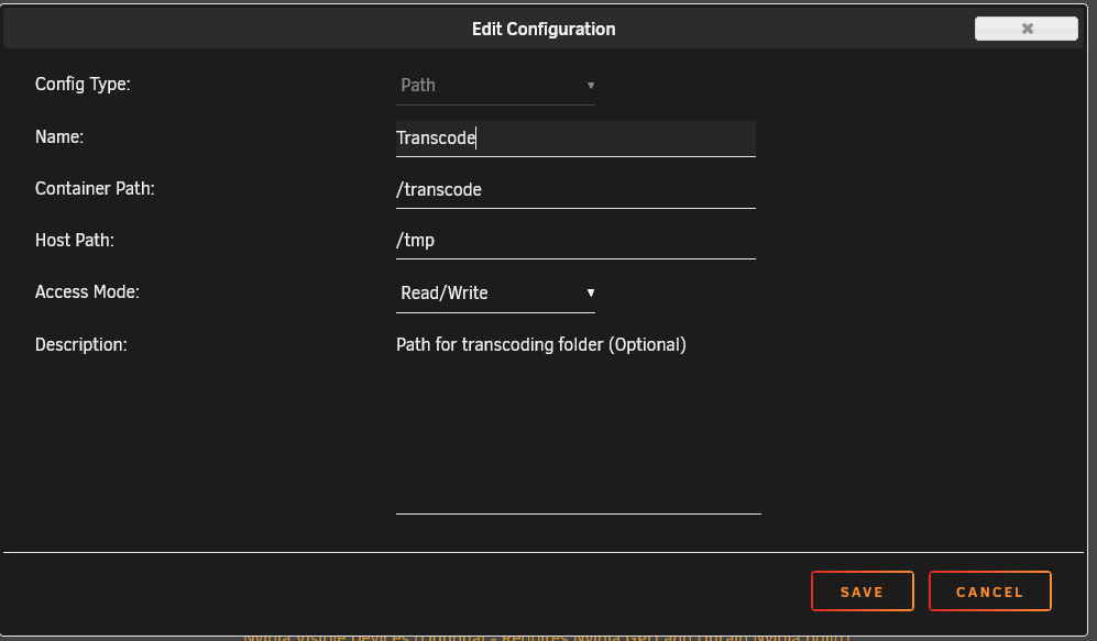

Thank you for your reply. How would I know if it is set to RAM? would be set to /tmp?
/transcode is correct on the Plex side if your Plex docker container configuration for /transcode looks something like this:
Basically, any host path not in /mnt (user, disk, disks, cache, etc) or /boot (the flash drive) is going to be in RAM as that is where the OS runs.  /tmp is the most common place to send things you want created in RAM.
