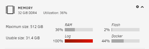

Spoke too soon. Filling up again.
"Fatal error: Allowed memory size of 134217728 bytes exhausted (tried to allocate 16777224 bytes) in /usr/local/emhttp/plugins/dynamix/include/Syslog.php on line 20"
What is the best course of action? Probably should get this fixed before upgrade to 6.8.3.
Fix whatever is filling your log file with these:
Mar  8 01:04:34 Tower nginx: 2020/03/08 01:04:34 [alert] 12791#12791: worker process 3179 exited on signal 6
Mar  8 01:04:38 Tower nginx: 2020/03/08 01:04:38 [alert] 12791#12791: worker process 3311 exited on signal 6
Mar  8 01:04:41 Tower nginx: 2020/03/08 01:04:41 [alert] 12791#12791: worker process 3665 exited on signal 6
Mar  8 01:04:43 Tower nginx: 2020/03/08 01:04:43 [alert] 12791#12791: worker process 3701 exited on signal 6
Mar  8 01:04:45 Tower nginx: 2020/03/08 01:04:45 [alert] 12791#12791: worker process 3729 exited on signal 6
Mar  8 01:04:47 Tower nginx: 2020/03/08 01:04:47 [alert] 12791#12791: worker process 3834 exited on signal 6

Updating to 6.8.3 seems to have resolved this problem. I would mark this thread as [SOLVED]
